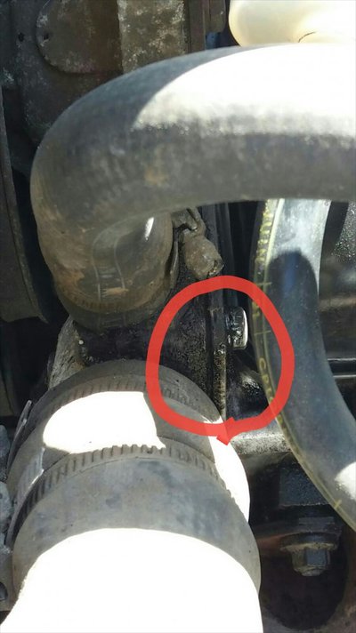

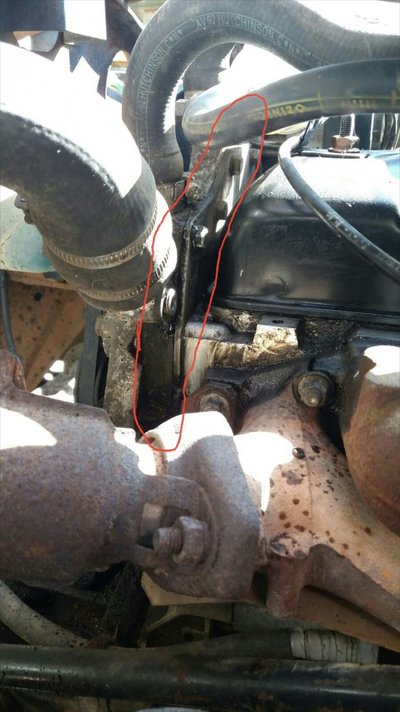

    Screenshot_2017-03-18-15-04-04.jpg Screenshot_2017-03-18-15-02-55.jpg View attachment 18002 Hello people hope everybody is having a nice afternoon. I myself am trying to locate an oil/black sludge leak within the depths of the gtl engine bay and have narrowed it down to what I belive is the water pump... question is if this is indeed the culprit would it not be leaking water also? I have taken a couple of photos to try and help pinpoint what I'm talking about. Any advice on what to do or what not to do as always is greatly appreciated. .

    Have you tried cleaning the sludge off with paraffin/white spirit/carb cleaner then you might see better where the sludge is coming from? Yes, that is the water pump.

    The only thing that could leak in that area would be the rocker cover gasket

    I think so too- looks like the manifold long side rubber gasket is not doing its job- maybe out of line. Oil is visible all along this edge down on top edge of the manifold

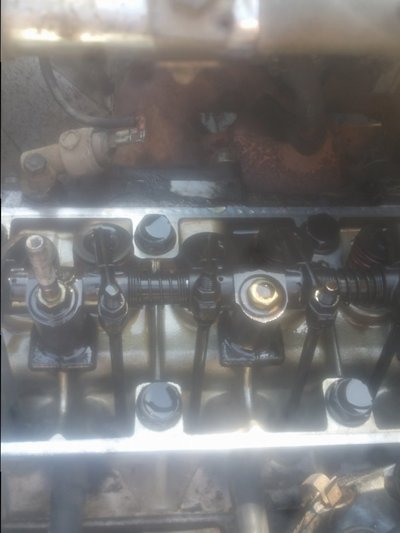

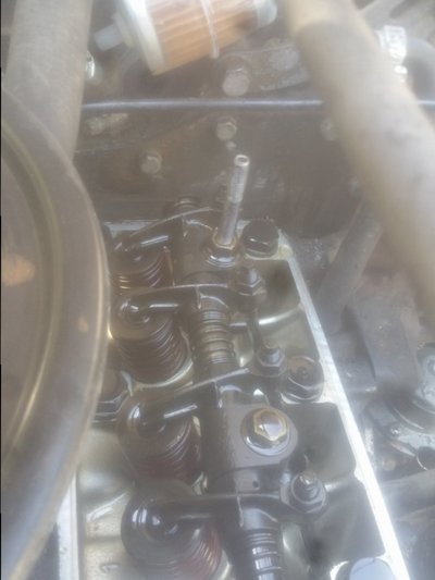

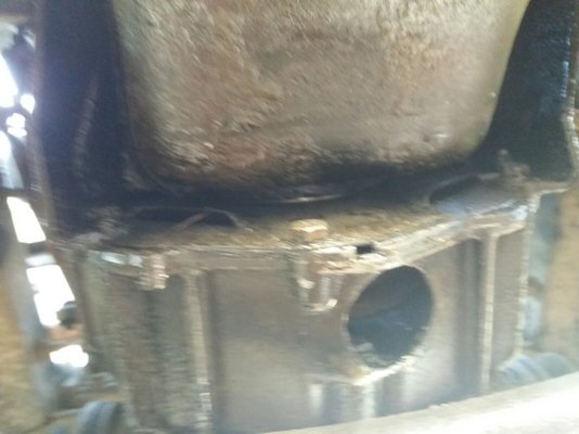

    Ok so……

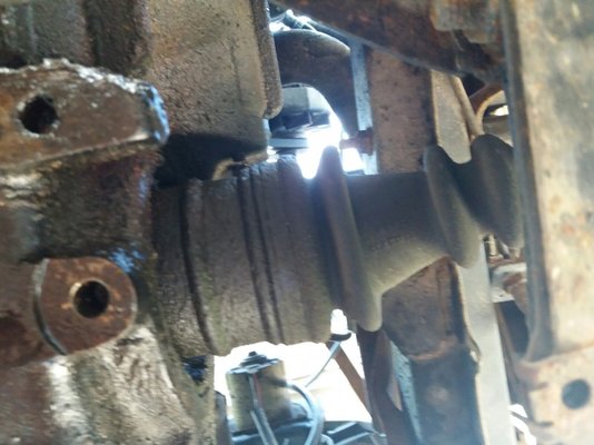

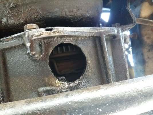

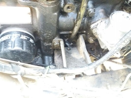

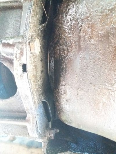

    I have taken the rocker cover off today to check the gasket as it was something installed myself previously. To my surprise and horror it was seated correctly and didn't seem to be the problem. I had a bit off a clean around and the only thing I could really notice was a trail from the breather pipe on the rocker box going down to the lip of the rocker box which holds the gasket in place obviously something is coming from there as the hose has no clip on it its just pushed into place, im not sure if this is normal but think a jubilee is in order.
    As chance would have it I had access to a flat drive way for an hour or two so I got the car up on stands and had a look underneath to see if I could trace it from the underside up, I now wish i hadn't bothered as there is black gunk everywhere and im more confused than ever. Where ever it comes from seems to be above the sump so im guessing its not the sump gasket. I have found that the liquid coming out seems to be a clear oil when it hits the floor and doesn't smell like petrol. When I first got the car the first thing I replaced was the fuel pump as it was spraying petrol everywhere so im not sure if that left crap built up everywhere and it softens when the engine gets warm and turns to liquid.
    photos will follow but please allow me to thank you all for your advice in advance as this forum and your collective experience is the best tool for a R4 novice and is greatly appreciated.

    If your rocker cover is still off, have a look in the inside and you'll find a plate spot welded to the top. Oil tends to accumulate there and can restrict the opening to the breather pipe. To clear it, swish some petrol around to loosen it and then find something to scrape out the mess.
    It's very likely that the rubber hose that leads from the breather pipe is clogged with old oil too and the oil fumes that are emitted are being blocked. Thats probably the cause of your leak. The oil would run down the side of the rocker cover, get caught up in the channel and flow downwards towards your water pump, where it would overflow..
    Hopefully if you clean out that rubber hose and put on a little hose clamp, your oil leak problem will disappear.

    Thanks for all your help Boys good face full of black sludge a sore back and a pair of jubilee clips seems to have stopped the leak. How that much liquid cam from the breather on the rocker is beyond me but who am I to question the mechanics of a GTL?
