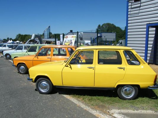

Hello Gary, you might be a bit mad but these are very rare cars now, much rarer than the four, so well worth saving I would say. I see its tax exempt so that is a bonus, and I believe it's a 4 under the skin, so parts shouldn't be too much of a problem. I've enclosed a photo taken at last year's Thenay gathering of some R6s. Are you going to make it to Thenay? Regards Brian.:cool:

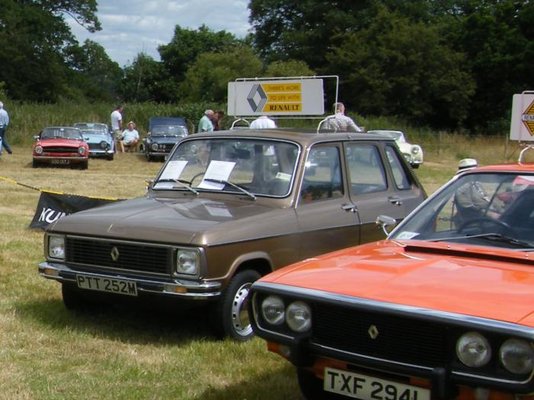

That might have been the R6 that Rob Doran down in Exmouth was selling. It's a cracker, very low mileage and only one owner before Rob, who I believe has hardly used it. The R5 Gordini sounds interesting, another rare car.
