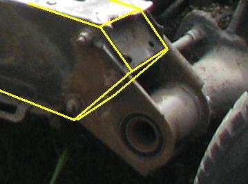

Has anyone any thoughts about this, is it a silly idea a bad idea or good idea?
I am proposing to wrap a peice of metal around the end of the suspension arm - this would result in a solid box with no places to hold dirt.
(The peice would fill in where the yellow line is)
It would be perhaps better to use a material such as ABS plastic, like modern wheel arch liners, I'm sure Malcolm has been trying something very similar with his Gordini.
Simular but not the same, looking at the pictures he designed his nicely from the begining. Im more looking to put this on to prevent the rust which will in the future occur!
So generally a good idea I guess then !?!
Very good idea. I am currently awaiting MalcolmMetal&PlasticsCo.Ltd. to start producing the first batch..
I would be reluctant to add a further double skin - they are the reason the suspension mountings corrode in the first place. Well worth sealing up any holes into the chassis member though.
Really it wants a cover on it to stop the mud collecting.
Ive sealed up the holes, still in two minds about putting the wrap around plates on.
It would make it easy to paint and clean etc so should prevent any rusting but then like everything, If it did rust you wouldn't see it :(
I go with Malcolm. You may prevent mud, but you won't prevent water, and its the trapped water that will cause rust. The best would be to replace the whole thing in thicker steel, plenty of waxoyl inside, and then well sealed holes.
Decided to leave it as it is and just fill the holes, Ive left one hole for waxoyl which I will then seal with a bung or something !

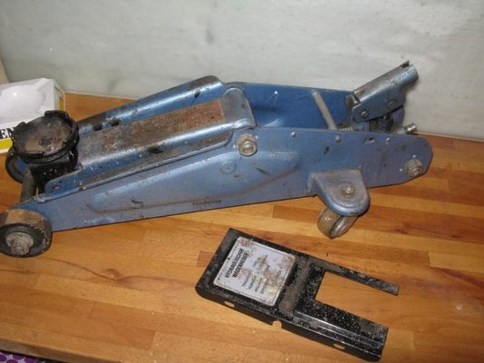

Pic 1. Jack.
you'll need two-Notice black sheetmetal-cover that's supposed to sit on top of jack (to make it look fancy?)These have been collecting dust in a corner as I need to take them off to get to the carry-handle of jacks so..........

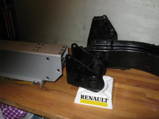

Pic 2. The Sore Toe/Lhs R4 rear-swingarm.
seen here with rear boxsection (to illustrate)
Pic.3 Remember black sheetmetal-cover from jack?
This will fit like a glove on to the topsection (slanted part) of swingarm
-Piece can ofcourse be measured and fabricated but as this is mainly about
having something for nothing by using scrap-pieces-We'll use these....

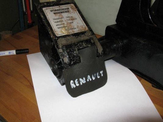

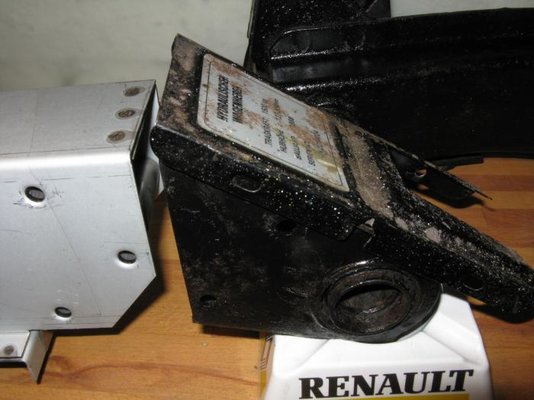

Now you decide how far forward you want the covers to sit-There is an overhang upfront-so pushed as far as it gets water and muck won't get in.
You can even bend frontpart of cover upwards to further hinder water.At least here in Norway-land we tend to take it for granted water will run downwards.. 'Cept my neighbour living downhill from me was mad as H*** at me as water from my prop.ran down onto his.........................
Pic.4 outerpart of top part swingarm points outward /innerpart points inwards so cover can be SLID on from rear,then you bend or give it a precise adjustment -i.e a blow with a hammer along the edges so it won't slide backwards and off..
Covers can be mounted on with wheels on-IF you are fluent in FRENCH..:mad:Otherwise take wheel off first!

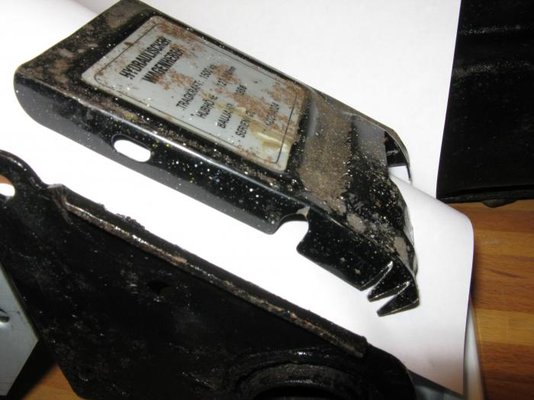

Pic.5 wanna get fancy???
Cut a couple V each side of cover,remove bits,bend so cover follows Cerule/rubber-joint
Superfancy???
remember my innertube? cut out fitting rubber splashguard screw or pop-rivet to rear end of cover.
Superduperfancy???
Heck!-you might even write RENAULT on it....

That's a very elegant solution. Hadn't thought of using the spring in steel to clamp a cover to the mountings.
