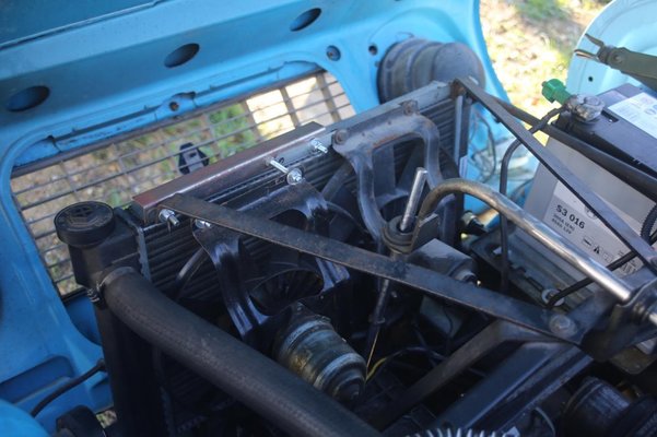

Whoops :doh: had an overheating problem and realised the temperature sender from the radiator to the fan had a poor connection/fault - decided to replace this and fit a temperature gauge and an extra fan connected to a switch on the dashboard.
This took a bit of time getting the spares but eventually got it done. The main problem was fixing the second fan as there is very little space and no where to fix the bottom of the fan. This was solved by using long bolts, so the the position of the fan could be adjusted so the fan blades didn't touch. The bottom fixing was solved with a stay across from chassis - two or three attempts before I got it right and clear of the gear box.

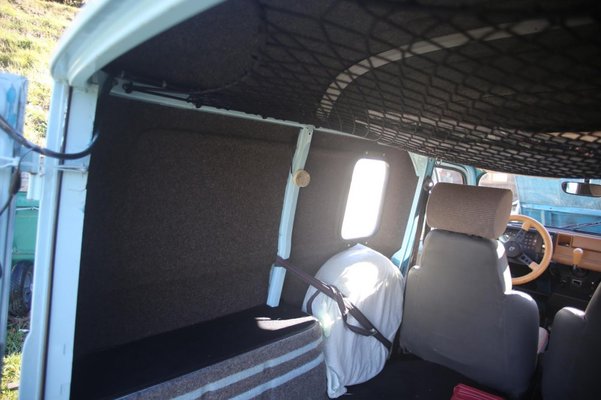

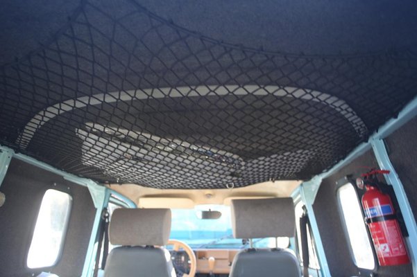

Next it was time to start on the interior. I wanted net to go in the roof so that we could store light weight bulky items like sleeping bags out of the way. We managed to find a very helpful company in the UK - Nets4You - Who were more than willing to make an elasticated net to fit the roof and supply all the fixings http://www.nets4you.com/ If you need netting like this have a word with them - highly recommended.
The other job I wanted to get done was to line the interior by gluing woollen blankets to the inside - this I found in my previous F4 van in the UK cut down on the noise level and also got round the problem of condensation if you're sleeping in the back. We found a local man who does car upholstery and interiors the glue this up for us.

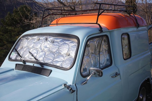

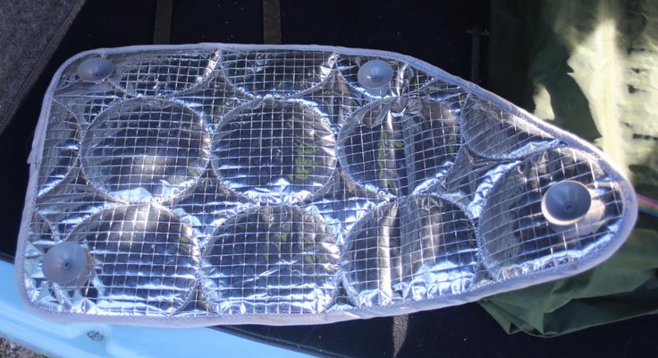

My wife did the next piece of work - making sliver screen insulation panels for all the windows all the materials obtained for local caravan/camping show rooms.

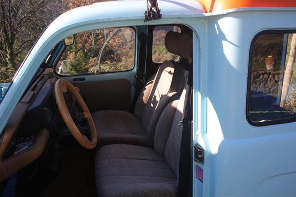

The biggest problem for the interior was yet to come - we wanted to replace the original seats as they quickly became uncomfortable over rough tracks. After doing some research we decide that semi-bucket seats from a Renault Alpine would fit and increase the comfort. The problem seemed to be the they were not fitted to all Alpines and as a result there were not many on the second hand market - most that were available seemed to be in northern France:mad:. After weeks of searching we eventually found 2 seats in reasonable condition at Saint-Étienne. Not to bad a drive but decided to stop over-night.
Fitting was quite easy - I needed to raise them by 30mm which was accomplished with some box section running front to back. All the bolt holes were a match which life even better.:clapping: You'll never believe this - a few days ago we were passing a scrapyard we'd already visited in our search when we saw a Renault Express van with the same seats in - as they say over here

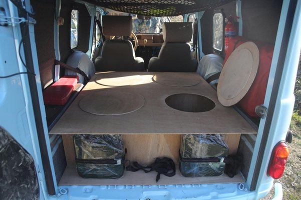

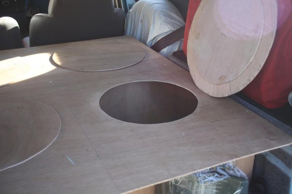

The final part of the interior work was to construct a storage box that fitted between the rear wheel arches - the idea was to create storage and leave enough space above to sleep on if necessary. I also wanted to keep it as light as possible so used 5mm plywood. My only concern was, would it be strong enough. This was solved by putting dividers in to split it into four sections.
As you can see this also allowed me to put in storage for two 5l jerry cans.

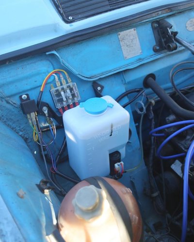

Thanks for all the comments/support, pleased that this posting is of interest. Recently I had to replace the window screen as the old one was very scratched which made driving into the sun or headlights difficult. We found one locally at a garage who kindly fitted it as well - problem solved. It make a lot of difference when you can see where you're going :o.
We also fitted a cigarette lighter so the we could run the GPS/battery and phone charger. Also replaced the window washer set-up. Originally this van had the foot operated pump which delivered a dribble to the window screen. This was change to a larger bottle with an electric pump so I can now spray 2 or 3 car behind as well!!!!!!

Hi pepper - yes it really makes a difference all the bits needed come with the kit, and the only thing I had to make was the bracket to keep it vertical. This is where is where I got it http://www.4lparts.com/electricite-...t-pompe-lave-glace-electrique-avec-bidon.html

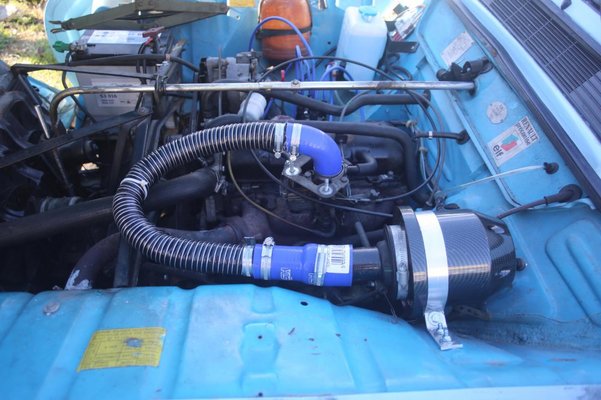

While we are talking about dust I've also fitted a new air filter rig as I wasn't sure the original was going to be up to the job. I didn't particularly want to fit a full snorkel so eventually decide on a good carbon filter in the engine compartment.
Not only does it look good :cool: but the engine is running much better - it sounds really smooth. Better than a Porsche!!!!!!!

You could use hinges to make more square opening for easier access to storage.

Hi - Petak thank for your comments. Yes I thought about using hinges but would have needed to use thicker ply wood and my main aim was to keep the weight down as much as possible. Thanks for the info on insulation material - no I'd never seen this material so just went with the way I did it in my youth!!!!

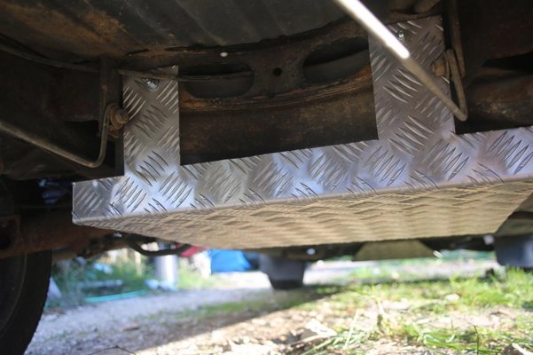

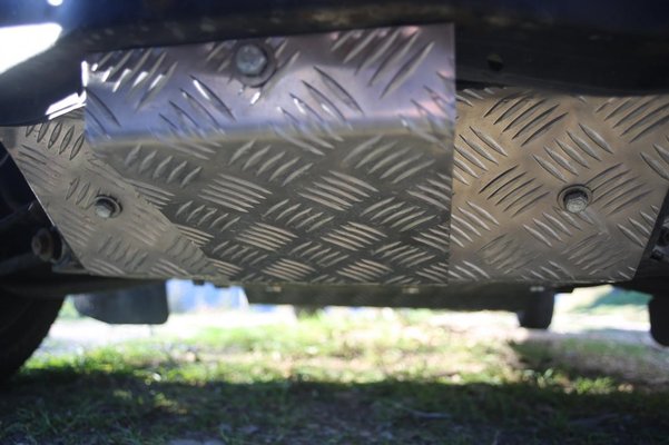

I have also fitted some protection plates under the engine and fuel tank. I decided to use some ready made aluminium - these were quite easy to fit as most of the hole were already in the chassis, I only had to drill 3 small hole for the fuel tank protection.
