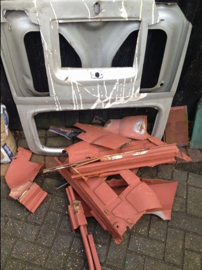

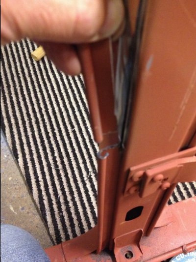

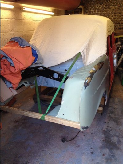

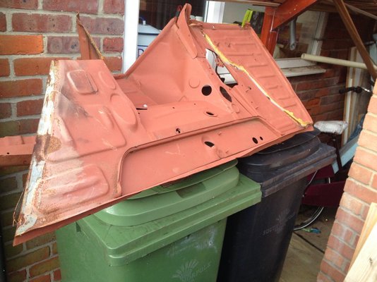

Thanks Paul...not out of the woods yet...a bit more fettling and lots of adhesive to follow...lets see how I get on tomorrow. Today met up with Jim E4GTL who had Several surplus spares from me. It's a great community on here . Took the remnants to the scrapyard not much left of that old body.....used every scrap! Kept back the bulkhead just in case I ever buy a left hooker from the Sunny South of Spain and change it to RHD and all electric!

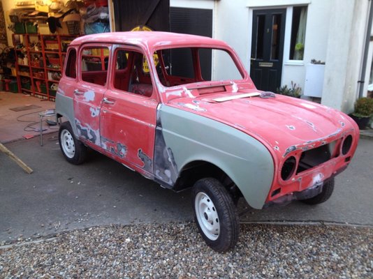

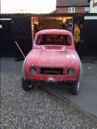

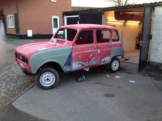

A front wing is on and together with the bonnet all aligned correctly. A prep session for the New Year...may it be a good fun one for all you R4 fans :clapping:

Looks much more like a car now fun is next trying to work out which bit goes where and which box it is hiding in
Nice progress JonathanT. Did you have hard time to align all pieces?
As mr reno says fun starts now. To put all back to right place.

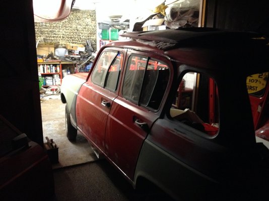

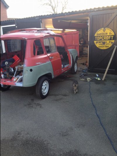

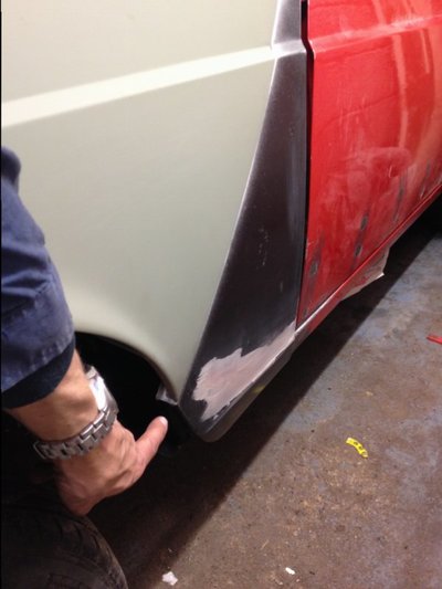

Ha! At last Womble has all his doors on....albeit temporary in an effort to align and fettle all the shut lines. Mini cat is inspecting new panels. Lot of work yet to do. The door patterns are different giving rise to differing shut lines on each side. I may deliberately trim the edges and weld seams up again to get more parallel or at least balanced shut lines on each side. The alignment of the front wing to quarter panel is poor on one side...despite the waist line being perfect. Rectifying this will be easier than reshaping the waist line

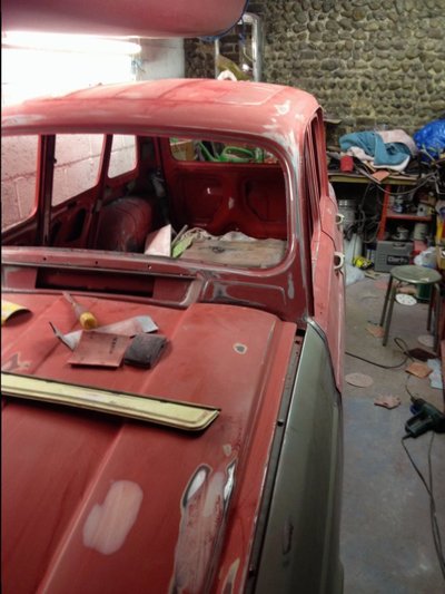

Time to post a progress report. Now onto detail rubbing down. Then detail filling.......Then detail rubbing down!....... Then detail filling!....... Then detail rubbing down .........Groan.Hey ho soon off to the paint shop

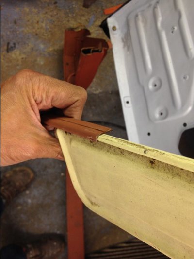

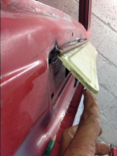

Have you modified the air inlet profile to host properly the metal flap?
It is a really interesting modification...

Hi Azzazello Yes it's a modification made possible by using a section of rolled edge door pillar ! If you look at earlier posts on my thread you will see how I made the hinge. I'm currently filling and sanding the junction with the body. I have a few more tack welds to do and it'll be finished. Will post some more photos of this detail soon

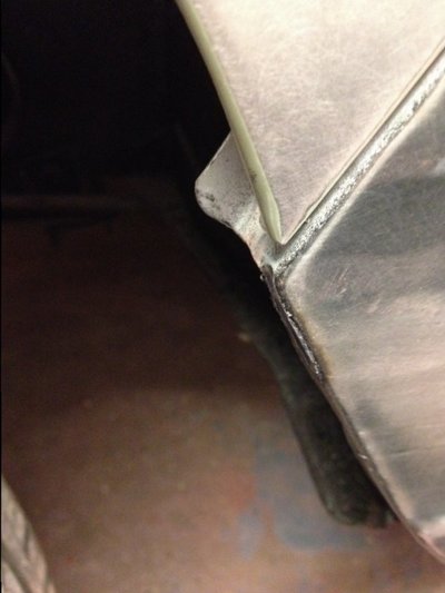

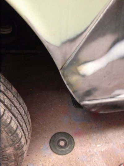

Mind you I did manage this last night . I had to cut and re shape then weld up the 'A' panel to a new line to align with the wing. The waist line is bang on...just this side didn't align just here annoyingly
