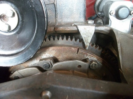

Hello Melissa
Your flywheel on an 850cc turns clockwise, so the mark on the flywheel should be approximately 1cm before the arrow. Which is 1cm before TDC.
In this position, the points will just be opening.
Use your Mojo Mellissa! Yup all good advice above and good pic by Mojo. The only thing I would add is that the valve springs and rockers are just visible from the oil filler hole on the top of the rocket box. A couple or three turns and you will be able to suss which is the exhaust stroke and which is the compression when your timing marks finally appear in the window on the bell housing
brilliant..thanks everyone..nothing like a crystal clear image to make sense of things Mojobaby..the new ignition parts are on their way from the Uk & I can't wait to get them in. One thing I have noticed when ordering parts..there are so many variations on engine numbers, different distributers & carbs etc..they did change things a lot!..I'm sure I will get used to it & I can't wait to get her running as she should be..thanks again all I know my post is somewhat simple but I'm a lot rustier than my Renault!

I make good use of all my old toothbrushes
I've dabbed a spot of white paint on the flywheel mark, so its easy to see.
