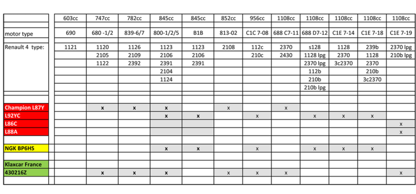

This is a spark plug reference list I always use, I'm not familiar with the Bosch plugs.
The clearance is OK, enough spare space, and never use copper grease, a bit of oil on the threads is sufficient.
Regards, Joop
Spark plug table by courtesy of R-Quatre

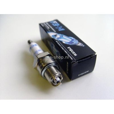

Long time ago (before big dismantling) I have used EYQUEM N43 with 3+1 mass electrode and it seems that engine was working perfect with them.
Nowdays it is hard to find them in Croatia

Just looking at the chart above, I have a 956cc in my R4 and the plugs are different that that of the 1108, should I replace mine with the Champion L92YC I have a feeling mine are based on the 1108cc that my local motor factor matched up and are Bosch plugs. Seems to run ok but I don't want to risk any damage
NGK BP6HS for my 1108cc (C1E 718) - same is suitable or your 956cc. They are the the short-threaded plugs and work fine (0.6mm gap). The Champion L92YC must have the same dimensions as the above NGK, as they are correct for mine too.
