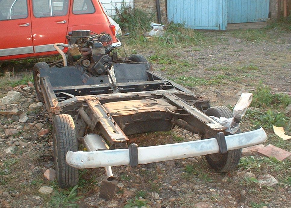

The Renault 4 has a separate chassis which includes the floor pan. New chassis are available from Melun Retro Passion and Der Franzose.
Renault 4 rolling chassis

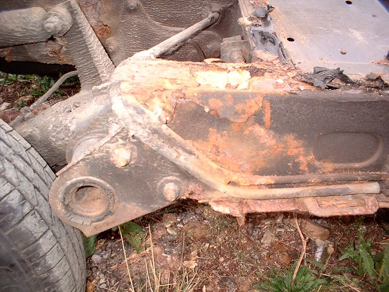

The Achilles heel of the Renault 4 is at the rear where the rear suspension bolts on. The photograph shows the RHS rear suspension with rust in the double skinned section just to the rear of the inner suspension mounting.
The rust will be obscured by the damper and is only visible from underneath the car (I've removed the body for the photograph).
Rear inner suspension mounting rust
A patch repair for maybe £200 would get the car through an MOT, but there's not much point as rust would return the following year, and the area behind the mounting would still be rusty.
A good repair would involve removing the rear suspension, the fuel tank and half of the interior.
Some time ago rust in this area would have been enough to send the car to a scrapyard. These days Renospeed (the Renault 4 specialist in London) can make a lasting repair for around £600, which is worthwhile, as the repair would probably increase the value of a reasonably tidy car by the same amount.
More rust in the rear inner chassis member

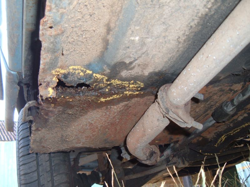

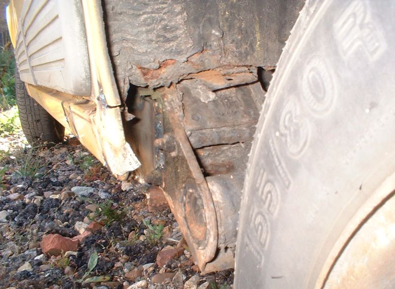

It's much rarer to find rust in the outer suspension mountings, but unfortunately that area is more tricky to repair with the body still in place. Really cars with severe rust in this area would only be suitable for spares or DIY restoration.
Rust in the outer rear suspension mount tends to start from the top and rust in the wheel arch immediately above the mounting is a clue to the mounting condition. This one is pretty bad.
Rear outer suspension mounting rust

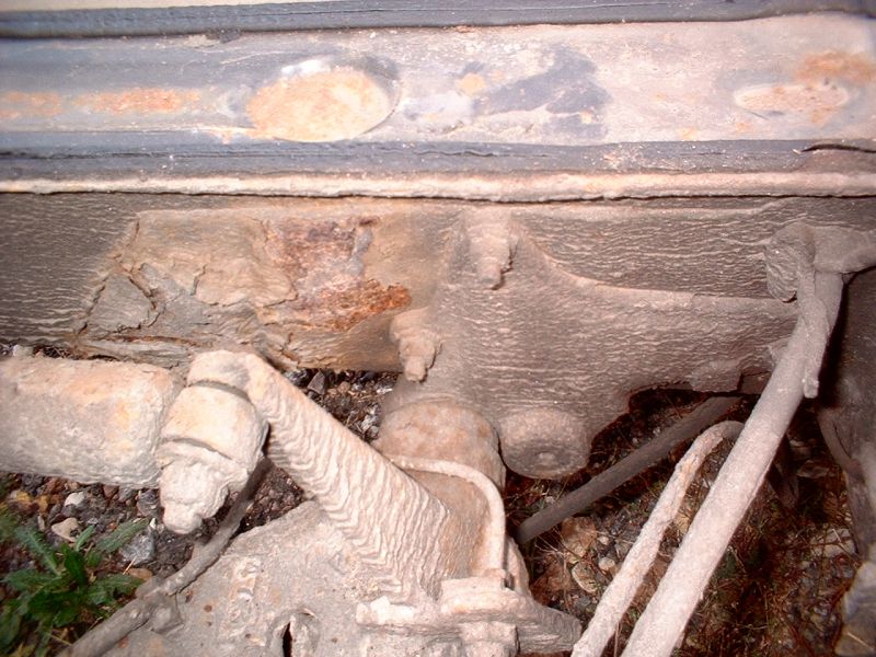

WIth the body removed it's easy to see where the outer mounting can rust. The top of this mounting has completely disintegrated.
The chassis also has rust on the double skinned section to the side of the mounting. The outer section of the chassis is visible just inside the sill panel, and if the panel is wavy or bubbly, perhaps with cracks or rust coming through from the inside, then an expensive repair will be required.
Another indication of rust in the rear chassis is the condition of the body just inside the rear door. This one has been patch repaired, so the chassis underneath is likely to be holed.
Body above outer suspension mounting

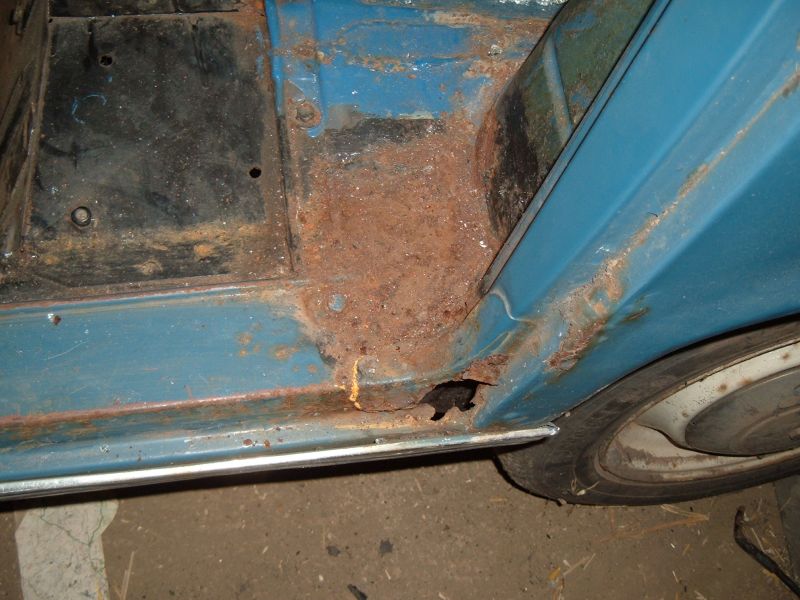

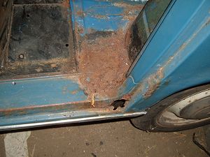

The four corners of the floor pan often rust, but patch repairs are quick and easy to carry out.
This one has been patched already but to a low quality. Replacement floor sections are still available for a long term repair.
Front floor rust

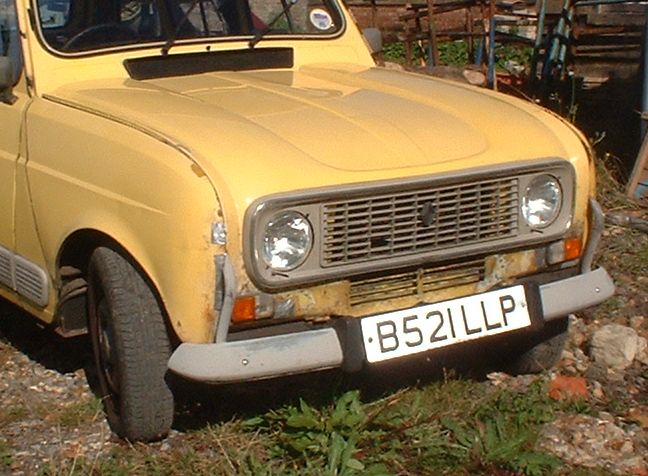

Issues at the front of the car are wings and bonnet. The wings will rust on the top and front edges, but can be replaced for £30 each. The GTL bonnet can rust along the bottom front edge.
Front of a Renault 4

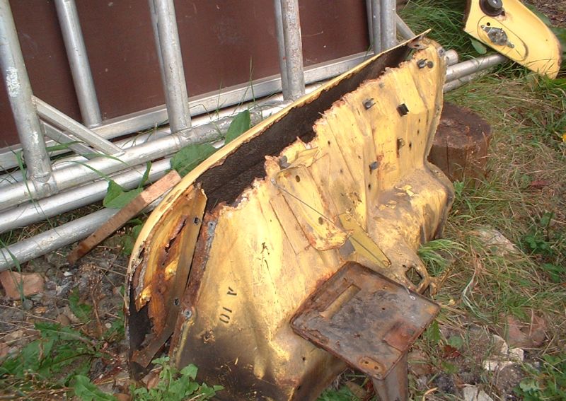

Rust at the top of the wing will spread to the inner wing. This is a bolt on panel but costs over £150. Repair panels for the top of the inner wing are available but need to be welded into place.
The front wings also rust at the front where mud can be trapped.
Front inner wing rot

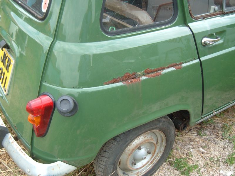

The original rear wings were seam sealed from the inside of the wheel arch, but most people don't bother when they replace the wings, and mud collecting on the top of the rear wing mounting flange will rot the body.
A repair panel is available for the body, but it's a tricky repair.
The only other part of the body to watch is the seatbelt mountings on the rear wheelarches. There is a reinforcement on the wheel side that fills with mud and rots away.
Rust in rear wings

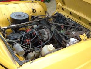

Renault 4 engine bay
Engine:
The 1108cc engine in the GTL is very strong, but doesn't seem to be completely comfortable with unleaded fuel - fast motorway driving can sometimes burn an exhaust valve. It's sensible to use 4 star replacement petrol or a valve protecting additive for long motorway journeys.
Any Renault 4 still surviving should have been well looked after, but some are neglected. The valve gear is visible when removing the oil filler cap, and will be covered in sludge on a badly maintained engine.

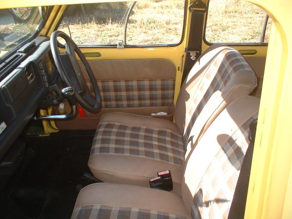

The GTL had cloth covered seats which tend to wear after around 80,000 miles. Driver and passenger seats are identical and can be interchanged to even out the wear. Replacement seat covers, door trims, and floor mats can be bought for the GTL
Earlier cars had vinyl covered seats which are much harder wearing. Replacements aren't available but they can be recovered by trim specialists.
Tartan seats
