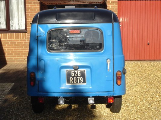

Been doing some electrics at rear of F4. High level brake light, reversing & rear fog fitted. Rear window needs a good clean and I will finish up removing all traces of the sticker that was in the LH corner!! Must have been put in with superglue or equivalent. Rear bumper being cleaned up before refitting it.

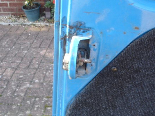

I do not suppose anyone has the cover plate to the rear door lock which is missing?

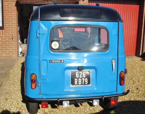

Bit of an update with activities on "BeBe". Named by she who must be obeyed . Blue & Black = BeBe.
Have upgraded the headlights to 60/55w P45T bulbs with separate relays for dipped and main beam.
Did a sidelight in headlight conversion as well. As I am planning to add side repeaters for the indicators have put the wiring in for later addition.
Modified existing wiring to add the reversing lights and also rear fog lights.
Added LED driving lights at front to extinquish when sidelights switched on.
Added wiring into dipped and beam beam circuits for later addition of spots and fogs maybe.
Gave up trying to remove an existing sticker on rear window so a Renault Classic Car Club sticker covers the spot.

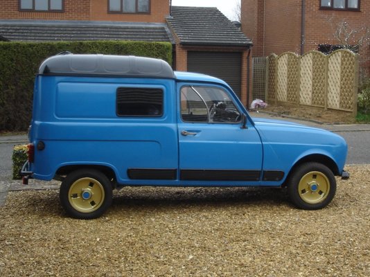

Possible alternative wheels. Speedline alloys which I had grit blasted and then have painted. No laquer on these yet.
