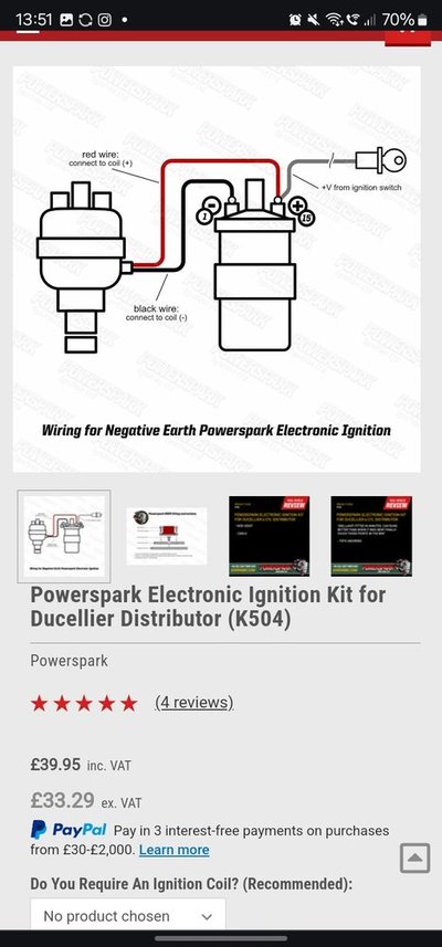

Has anyone converted to an electric ignition kit? wouldn't this remove the need for the correct ignition curve set by the correct code distributor?
Ok promise I won't post anymore,
Realised I'm wrong, regards electric ignition.

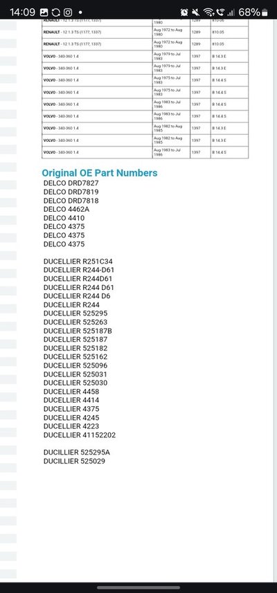

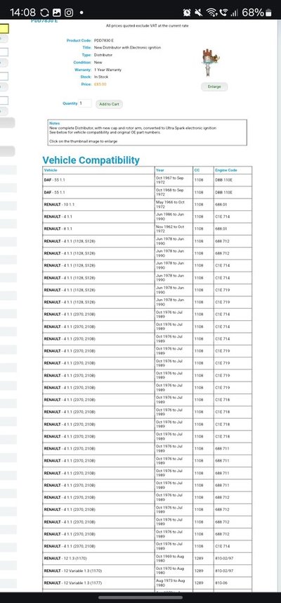

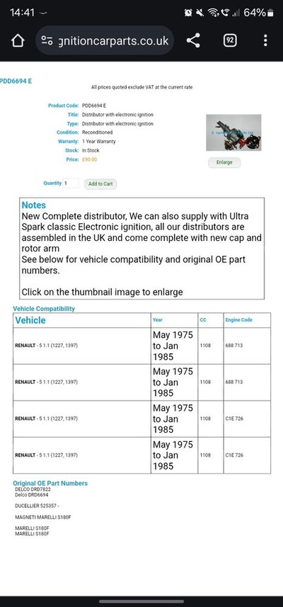

How does this look to you?
Should I go for the R4 or R5? Since I have an R5 carb
For a true electronic ignition the 123 ignition is the one to be https://123ignition.com/product/renault-4-r-v/
But you don't need electronic ignition to make a car run good, better or best.
