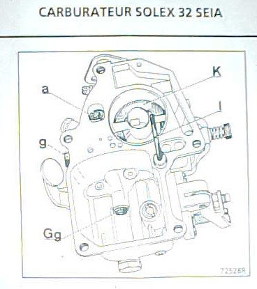

my '78 GTL uses this carb, and I'm not too pleased with it - the car seems very sluggish. I'm thinking of converting to the 28IF setup from later GTLs or hotting up á la Hennessey.
The carb is a bit of an oddball as (I'm not that technically minded, so YMMV) idle revs can't be affected directly but only through a combination of adjusting air and fuel mixture. Don't mess with the throttle either, because that's factory set and the gauge is hard to come by.
You can get a repair set (although mine had the wrong size jets) from www.reno4er.de
I've retyped the jet sizes from a French leaflet, so I don't know the correct names for the jets and measurements concerning this carb, but here goes, and you can compare with the drawing:
Buse (K): 22
Automaticité (a): 115
Gicleur de ralenti (g): 145
Pointeau: 1,5
Ouverture positive du papillon des gaz (mm): 0,90
Niveau d'essence (mm) 11,7
No. de calibre: 71644024
Emulseur: X6
Injecteur de pompe de reprise (i): 35
Angle de papillion (en mm) 3,48
Course clapet de degazage (mm): 3 à 4
Regime de ralenti en
tr/min. 700+-25
% CO 2,5 +- 0,5

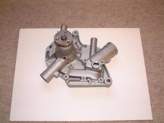

Gary, when you say you cleaned the carb was this a complete strip down and all drillings / airways blown through with compressed air? When you checked to see if the pump is working did it shoot a jet of petrol into the venturi without hesitation? I overhauled my 32IF with a kit from the Carburettor Exchange (Leighton Buzzard) so I never experienced the problems you are having. The 32IF is a simple carb and it should work as well as the 32SE1A.
I'm not sure what you mean by the small plate.
The correct water pump should have two outlets for the hoses to the heated manifold at the base of the carb. I cannot see these in your photo.
If you know somebody with a 5TL using the 32IF then it would be useful for you to look at the pump and the layout of the hoses etc.
Steve this one is on e bay at present is this the one the one.
Can anyone post me a picture of the r5 pump installed in a 4 with the pipes to the carb
Thanks Gary

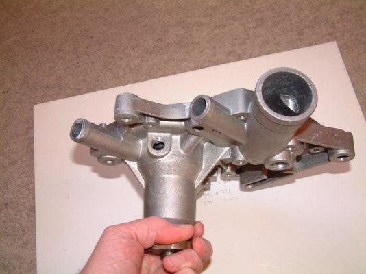

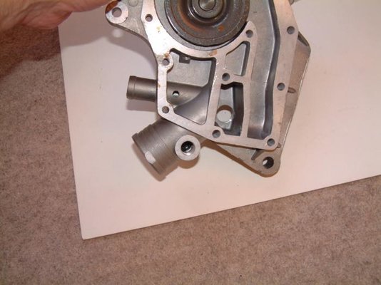

Gary, the ebay one is not correct. I have just been down the shed and looked at my spare water pump. Was going to take some photos but the camera battery needs charging. However, the body looks the same as your first photo except that the pulley flange appears to be wrong. The correct pump you need is
http://www.firstline.co.uk/op3/f_gr...+1282.jpg&product=Water+Pumps&action=graphics

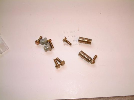

and it comes with the small metal pipes that screw in the pump body where you attach the hoses. The hoses are a Renault part and are moulded. There are three hoses - one long one and two short ones. In between the short ones is a bleed screw so you would need to obtain this as well.
A photo of a R5 would also help you. I will try and post some photos of the pump if you wish.

Here are photos of the pump and the fitting kit - where have you ordered yours from??
