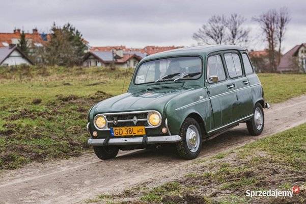

But recently I saw an offer for a trully stunning R4 in my country (Attached in the photo), and for a decent price too! (22k PLN, so a little over 5k Euro)
And aside from the fact that the engine seems to leak quite a bit and a bump on the side, the car seems to be in a really good state.
But again, I'm not a super experienced driver/owner, so I wanted to ask for advice since I really, really do want to take good care of this car (if the deal does go through, that is).
So, is there anything I should look out for? Or something specific I should ask the owner about?

Following on from my previous post elsewhere : given the presence of the starting-handle hole in the bumper, this car is almost certainly equipped with an early-style gearbox. This requires care when changing from 1st to 2nd (or vice versa) otherwise the gearbox can be ruined. The technique is called ‘double-declutch’. If you buy this vehicle read up about this online and practice carefully.
As ‘jjad’ says : chassis rust is the killer. There were, I believe, 800,000 R4s imported into the UK : our dreadful weather has finished-off virtually all of them. Look very carefully at the rear axle mountings coming off the rear chassis. If these break it is very difficult to repair them.
Those points apart, R4s are pretty well foolproof. This Forum is a good place to get specific advice.
The early 4 speed had a starter handle hole too. The bonnet on the car is shaped to fit the later front crossmember which was fitted to accommodate the extra length of the 4 speed. That one should be '68 to '73 with an 850cc engine, 4 speed dogleg first gearbox, and nice seats. They are my preferred Renault 4.

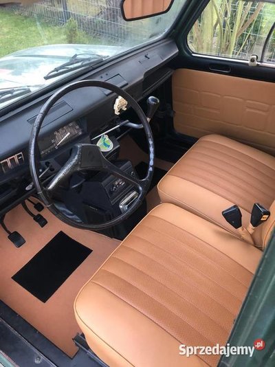

Amazing deduction! It's a '73 845cc engine, and the seats are very nice indeed, they're part of the reason why I like it so much.
If the chassis is as good as the interior, looks like a great find!

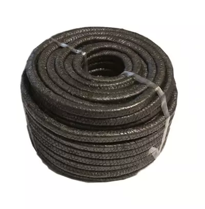

Okey so, Update for the engine leak- It seems like the problem isn't the seal, but the Grease Cord (I hope that's how you translate it-) and it can't really be replaced without taking the engine out
The owner had it repaired once before, but it seems like it wasn't done well and so the car started leaking quite badly again.
Still, it seems like an easy enough repair? I assume a knowleagable enough mechanic could get it done without too much of an issue, I hope.

Could you tell us what the Polish term for the place the oil is leaking from is? 'Grease cord' is likely to be an example of L1 transfer.

Also, from what I gathered the "Grease cord (or Tallow Cord)" is essencially just the seal for the shaft (or a pump?) that a bunch of older car used to use, so there's that I suppose?
I wish I could give more details, but again, the car is 500km away so I only know what the owner mentioned in our brief phone call and I don't want to bother him too much right now.
If it's helpful in any way, the polish term for the cord is "Sznur Łojowy" and it looks like that
