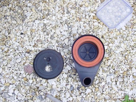

Is your filter a tight fit in the housing? I can't find that size either. It may be useful to post a photo on here so others who own earlier models may be able to help.
air filter
It's a little bit on the dark side now to take a photo but the air filter fits quite snug, with around a 1mm of room all round so it looks the correct one.
It's exactly the same shape as all the other R4 air filters, just the size that is different ,I thought perhaps it might have come from an old mini or as such like.
The trouble being there is no manufacturer or number on the filter to identify it.

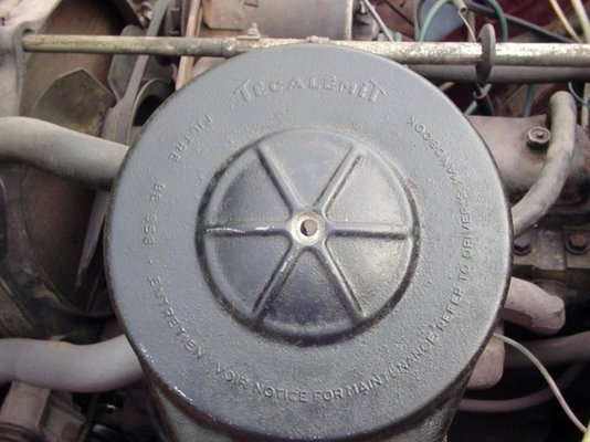

The air filter box is a Tecalemit 8E 658 and the filter measurements are height=55mm outer diameter=175mm inner diameter= 115mm.

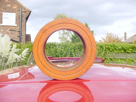

Must admit that it looks like the original filter. On the old element is there a part number and make that could cross reference? If you can get a K&N that does the job then go for it - you then have a filter for 'life'!!
old filter
Hi Steve,
there is no identifying marks on the old filter which makes it pretty hard to get another one, I've even tried the French and German Ebay motor spare pages but no luck.
