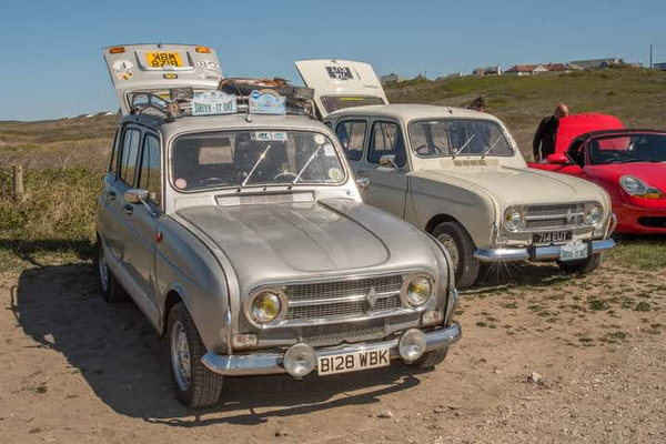

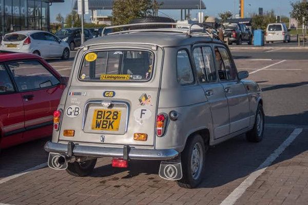

My 85 car has had the retro treatment, started by the previous owner, and continued by me with the OLD roof-rack, 60s I reckon, and the rear number plate surround. As the paintwork has faded over the years, and the plastic side panels too, I'm quite happy as they are. I've also painted the air-vent met grey.
As for changing the dash-board, hmm not sure about that. Bit of a faff for nothing I reckon.FB_IMG_1619600643587.jpgFB_IMG_1619600571826.jpg
