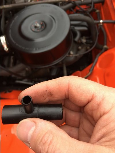

The carb looks quite basic.looks like two screws. One for idle speed the other for mixture?
malcolm
& Clementine the Cat
Staff member
4,186
Bedford UK
#9
The vent hose that goes from the T piece to the manifold should have a plastic restrictor inside with a 1mm hole. Without that the carb will run way too weak. You could plug the hose completely for a test.
The mixture screw is the one in the carb body. 1.5 to 2 turns out from fully in is a good starting point.

#16
If you replace the hose and put the restriction back in. You have a good base to start tweeking.

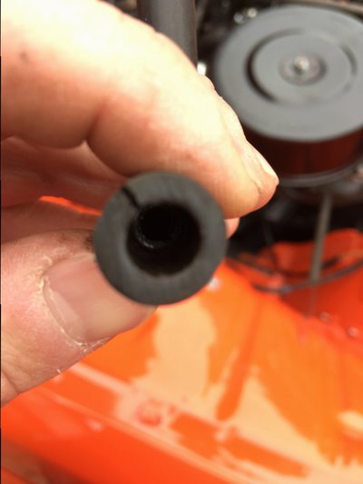

There is something inside the hose at the manifold end the picture may not be clear. But it’s bigger than 1mm
harbourseal
Renault R4 Lunatic
903
Breda The Netherlands
#18
The actual hole in the restriction is 1.3mm
You can make one yourself.
Take a 8mm bolt file the tread of and make it fit snugly in the new hose. Then shorten it of to about 6mm an dril a hole of 1.3mm down the middle.
And presto there is a new restriction.
