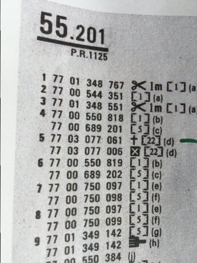

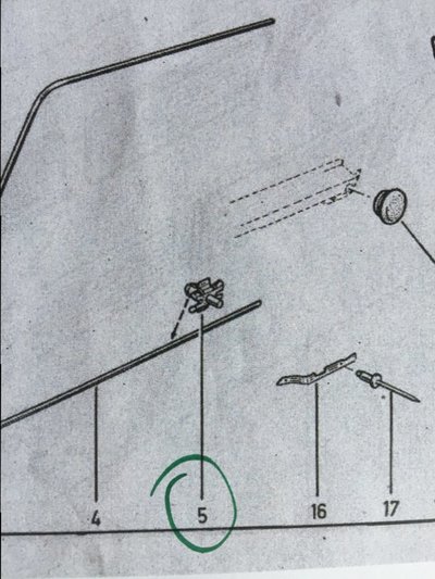

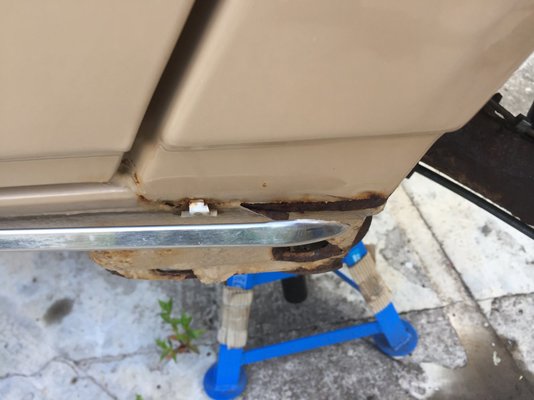

Thanks so much for all your help with my 1983-1984 Renault 5tl .... but I'm back with another question and a query... query first- does anyone know where I can source some clips that hold the metal trim on. I know there's at least two gone so wanting to replace them all on both sides (I figure it's better the metal stays on the car, not the road...) I've found the part number (I think!- thanks Andy!) but don't know how many it takes and where I can find some.

No problem Tomi, happy to help. You might find those clips or something similar on the de Franzose website. B.

Those clips are not easy to find . If completely stuck automotive double sided foam sticky tape is brilliant and makes an excellent job
