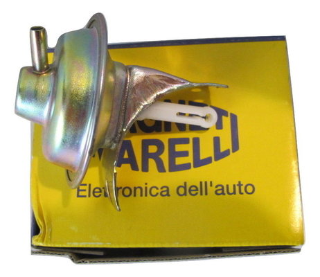

Hi mojobaby - many thanks for that link and interesting video! Unfortunatley, https://elecancetres.com doesn't have a vacuum unit like mine - it has a plastic clip that pops onto a ball in the distributor. Picture of what looks similar to mine is below. vacuum unit R4.jpg

Hi again Andy - I think that you are correct; I am ordering one of the above, 71293702, also known as 071293702010. I also feel that it was fitted to the Super 5, and the vacuum unit matches a Super 5 for a 1.1 engine like mine.
I suspect that at least in some cases, a change in part number indictates what direction the vacuum tube points, so hopefully this one will work, since the orientation at least is correct! I have no idea if the diaphragm 'leverage', or the stroke travel vary between similar-looking models.........
Other part numbers for Magneti Marelli/Ducellier vacuum units that look as if they would also fit are called '71293702', but with the last number as a 1, 3, 4, 5, 6, 7 or 8 instead, depending on variant.
