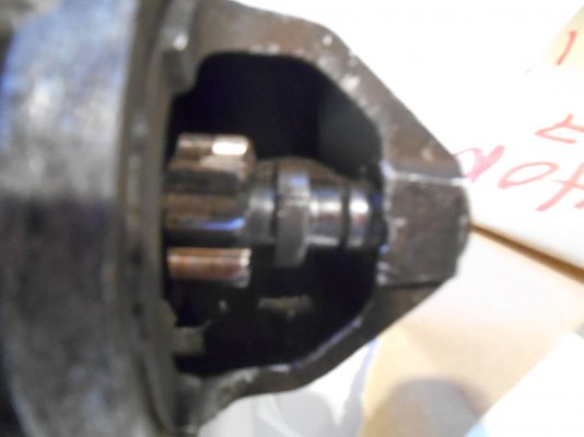

ARGHHHH ouch ouch, bugger it etc etc etc. But got it off in the end. checked it and it is knackered, the bush thingy at the end where the pinion flie out is smashed and split. Cant see one as spare to rebuild it. So seeking a new starter.
It is a Paris Rhone D9E68, i think I have found a suitable one in Germany on Ebay https://www.ebay.co.uk/itm/Anlasser-0-9-KW-Renault-R12-R5-R4-Trafic-1-1-1-3-1-4-TS/202760659430?ssPageName=STRK:MEBIDX:IT&_trksid=p2060353.m1438.l2649
Also this one https://www.onlineautomotive.co.uk/...AfQA2ADQAdwBYAEwAbABJACcAWABcAE4AIwAhAFgANwA=
Cant get hold of either at moment but will try monday to confirm it fits.
Anyone know anywhere else I can get one.
Cheers Gary
