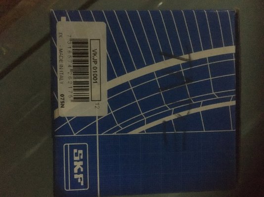

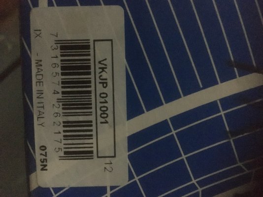

See the post - the SKF gaiters I bought have proven to be superb. They are very good quality - I think I bought them from Mr Auto as recommended by our fab forum friend Mr Reno
Here we are ...... just been out to the shed. I still have the boxes
