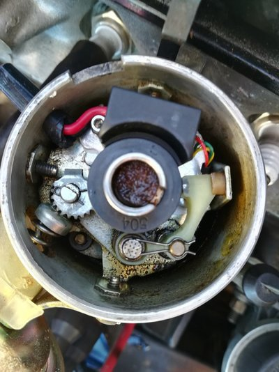

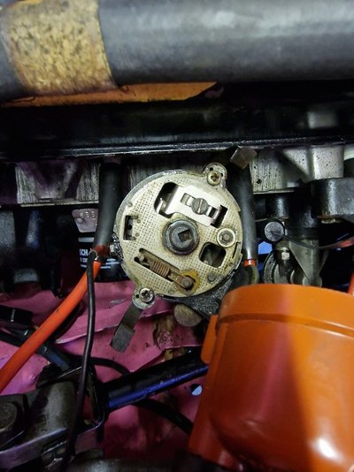

Quick question... what distributor is this and what are the best options for electronic ignition
Hi
It is a Femsa distributor. I cannot advise you on electronic ignition options. However, do a search on this website, there are members who have had positive experiences with fitting electronic ignition.
Personally I like Boyer Bransden. They're one of the pioneers of electronic ignition and have had a great reputation for reliability since the 1970s.
I've used their points-assisted system on my own and customers cars (& I sell it on my website).
The trouble I've had with original distributors is the advance springs no longer give the right advance curve. I've also used 123 ignition which replaces the whole distributor.

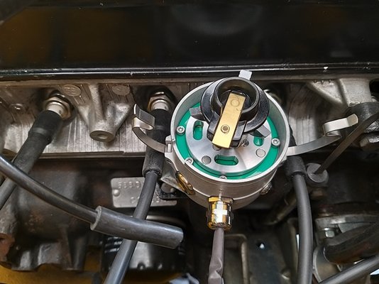

From what I have seen, you need to mark cyl #1 on the distributor and then turn the engine until the rotor pints at your mark. The timing lines should then be aligned on the flywheel. I have spoken to 123 and just placed my order.
I've installed it a few months ago on the billancourt engine. Cleon is similar system. It was a 30 minute job. In 15 it was running good. After an other 15 minutes finding and using my timinglight it was perfect! It is dead simple to mount if you already understand the basics of timing your distributor. It has a LED with tells you enough to start the engine.
I installed my 123 Ignition distributer today, and very impressed with the simple design and set-up. And the built in LED makes it easy to set the static timing. It is a quality part made in the Netherlands. The vacuum advance is only an extra option, so I just blocked off the vacuum connection at the carburettor. My R4 now starts first time !

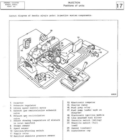

On the other hand, an idea for another project is to change the engine and add a Bendix monopoint injection an ignition so no vacuum is needed :whistle:
