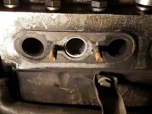

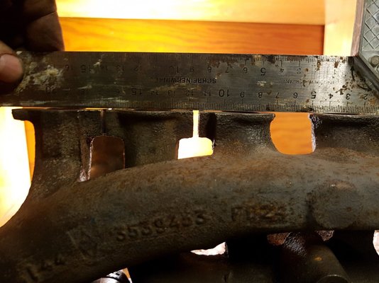

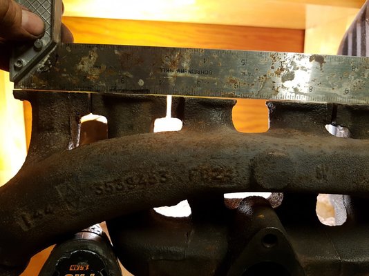

I think I found problem. From what I saw on internet and from experience from some mechanics problem should be in broken manifold of manifold gasket is leaking. Did anybody ever heard of broken manifold on Renault 4, because I didn't.
But on the other side, I changed the gasket 2 months ago (Victor Reinz), so I don't understand why it would leak that soon.
170
Poole
#13
I had my manifold skimmed because of bad distortion - unsure why, but exhaust and inlet branches weren't level with each other at the cylinder head, so unevenly clamping down.
I currently have a chronic manifold to first pipe leak, which - despite a new pipe and four different re-assemblies (with two different pastes) - is determined to leak after a couple of months. I re-seal it for the MOT and give up in-between times now!
