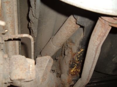

I have found one with a new CT, but has a few problems hand brake cable and a few other silly things, I have only seen pics so cant be sure of the chassis. what is the most common spots for rust?
It's very common to find chassis rot around the inner rear suspension mounting (hidden behind the damper) as in the photo. That can cause the car to sag to one side. The outer rear suspension mounts can also rust, and to fix them the body really needs to be removed. Also the 4 corners of the floor can rust, although they are easy to patch. See the chassis welding page for more photos of where the cars rust.
