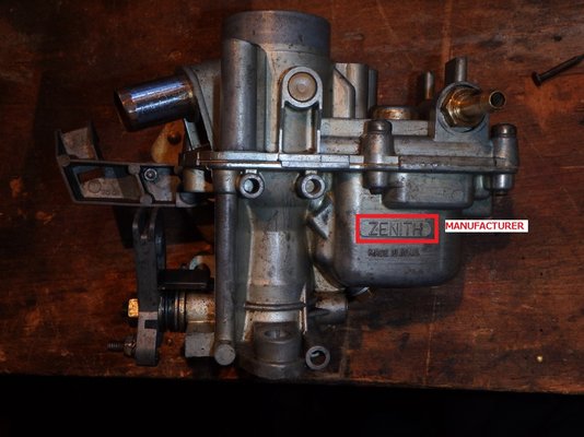

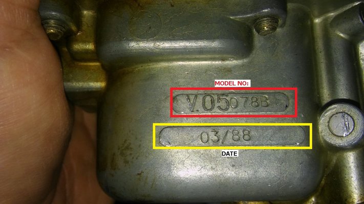

I think I have a Zenith 28if but how do I check if I actually have that one?
petak
1,640
Vodice, Croatia
On side of the carb body should be stamped name of manufacturer and model numbers and date of manufacture
Zenith 28IF cab be slightly different from model to model depending on car/engine to fit
