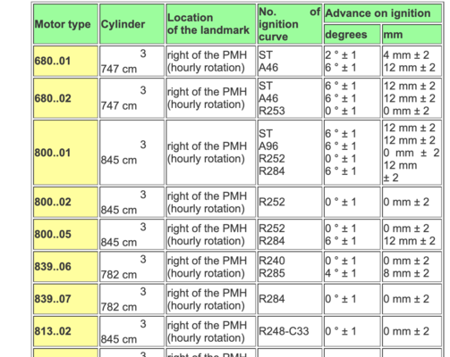

there sure is..it's nuts! luckily I found this before buying one so every single number matches!
do you know what an A or a B stands for at the end of the numbers on the carb?
I'm in France btw
As Paul already pointed, it's normal for the dizzy to have two different springs. Don't mess with it, just make sure the bobweights are clean and free to move and -most important- the shaft has no lateral play in the body.
Your carburettor is not correct for your engine, these having the vacuum advance pipe were either to be fitted on 956/1008cc engines, or very late ('84-'86) 845s.
I assume you have at least plugged this pipe. Check carefully that there are no vacuum leaks at the carburettor base or at the inlet/ exhaust manifold.

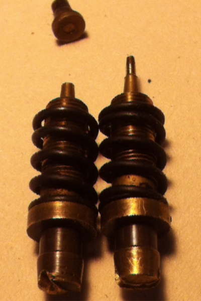

I thought I'd found the source of the problem when I found the needle had snapped off inside the carb in my old carb

I ve said this earlier and will repeat with airfilter off looking into carburettor intake willing to bet you will see fuel literally flowing into manifold will match the lumpy idle moments
In theory adjusting carb will be fully in too weak engine stops
fully out too rich engine chugs and stops too
If at no point between in and out it improves to a sensible idle forget carb adjustment and try new one
