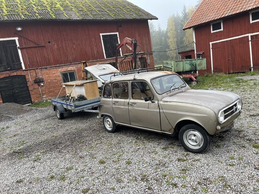

We started winter preparations bringing fire wood from fathers farm. 3m3 on three trailers so I guess we had massive overload.
Trailer weight for GreenOne is 500kg maximum and trailer itself is 200kg so net load is just 300kg legal. Some weeks ago our municipality gave away 500m2 concrete slabs 50x50x5cm for grabs. We managed to go five rounds 15 slabs (450kg)on trailer and three (90kg)in the boot.

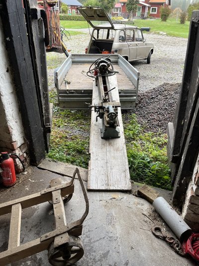

Today we drove some bushes/trees to fathers farm and picked up a lathe that have been sitting in his shed for 10-15 years. Dismantle as much as possible so i can manage the weight by myself and experience.
New place for the lathe is in my train shed, so managed to ensemble most of the lathe bet it had a rough time so som welding and fix is needed.
Think I sorted major stuff today. One thing that is good with my father is that he know how to use oil, so everything is well lubrcated

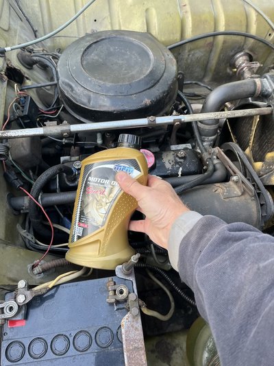

All this hard work GreenOne managed really good but fuel consumption was worst ever with 0,84l/10km. Front wheels also suffered from start with heavy trailer resulting in skid marks on first gear.
Half a liter 10-60 oil she got in the morning.

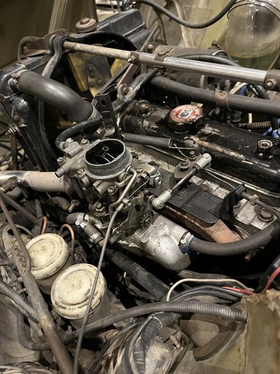

Something I have to sort soon is connecting the choke mechanism cos she is running rough before working temperature.

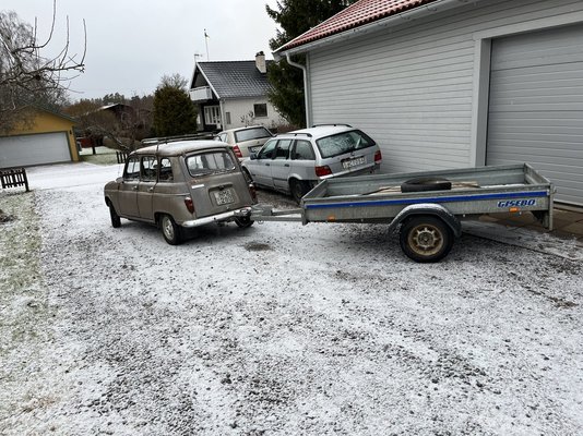

GreenOne have no easy enthusiast car life.
Its a hard working Renault , mostly the trailer is hooked up behind transporting firewood, garden machines, furniture, building material, car parts etc.. I guess it´s treated like in the 70, 80 and 90s a good reliable work horse.

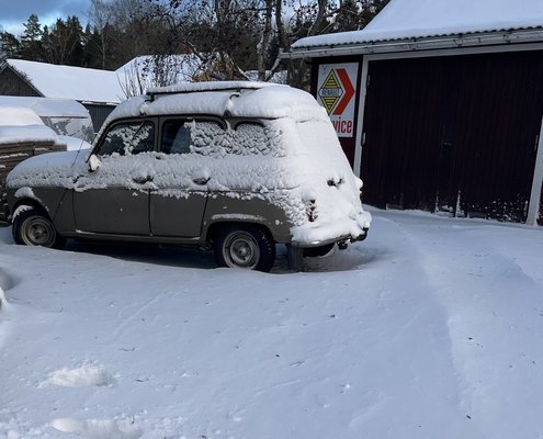

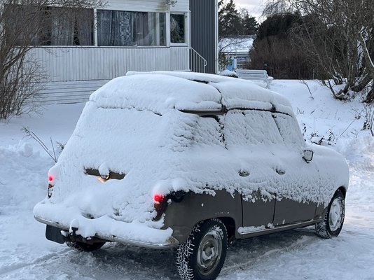

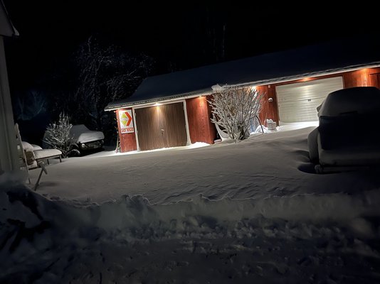

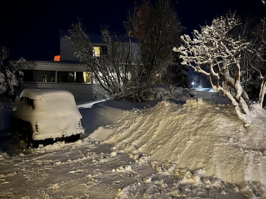

Winter starts getting a grip of us here in Sweden so I had to fix the choke. Though I had changed the carb to an 35mm the choke cable were supposed to sit on the opposite side. Could solve it with a longer cable but I always do things my way so I the other way around. Not right but i works. May be fixt correctly withe a longer cable sometime.

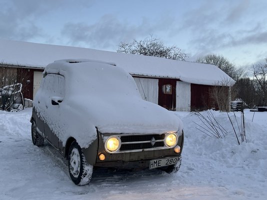

The other week we got 40cm (15") snow during a day happily it melted away week after but it high lighted the I need new winter tyres if I´m going to drive GreenOne during the winter as well also need to upgrade coolant so it can stand -25C
Got my lambda bung nut plug so I can take out my wideband lambda from the car.
Now I just need to give her som TLC so she copes with the winter Climate.

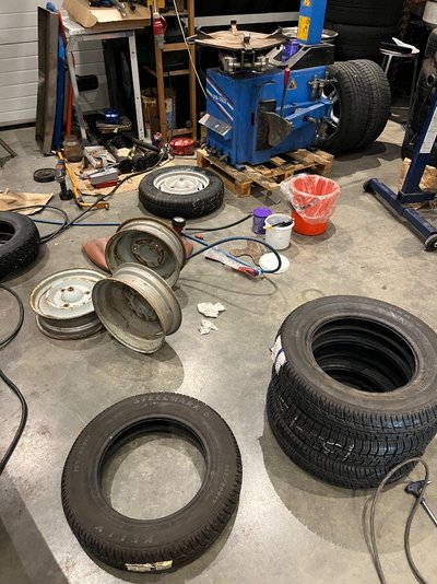

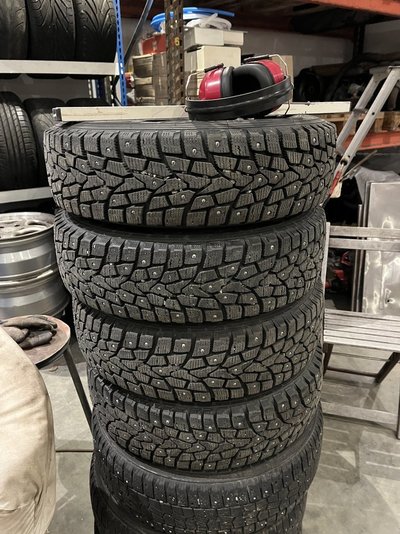

Green One have come in the garage for some TLC. Last trip when picking up fire wood from my fathers place the rear hatch handle had frozen so I had to pick things through the car from the hatch.
Bought some almost new winter tyres 155-13 to a VW Polo, right dimensions so started take of sommer tyres from the front wheels and fin two more rims that look the same.
A bit surprised the were no inner tubes just modern valves and tyres. Hmmm ok it seems to work so I just cleaned mating surface rim to tyre, put in new valves and mount tyres. Some fiddeling later all tyres was on the R4 rims.
Balancing seems impossible nowadays here in Sweden. How are you balancing your tyres?
After one day inside varm garage with my de-humiditer car was dry inside out and the frosen rear hatch handle defrosted. More work needed but one thing checked at the list.

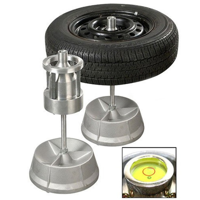

Self balancing is also possible all you need is a base cone exactly water level and a second ring on springs.
1. Be sure the contraption is level without the wheel
2. Put the wheel on and read the water level deviation, put the right amount of lead to correct the deviation so that it's level
3. Flip the wheel and repeat step 2 and job's done.
This is a method of statically balancing wheels, which does not take into account lateral imbalance that can only be fixed by dynamically balancing a wheel.
Problem is that, wheels without a centre hole (or with a smalll hole) need a special adapter to be fixed on a modern balancing machine. Almost no tyre shop will have this adapter, as they don't expect to come across such a wheel nowadays...
Good news is that, up to 100-110 km/h any dynamic imbalance is hardly noticeable, so if your wheels are reasonably true you are not going to have trouble in the typical R4 speed band.
Guess I was lucky
No imbalance notable at any interval up to 120km/h.
Have you any pics or links to how adepter looks?

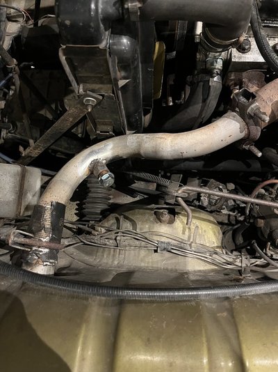

Some more TLC.

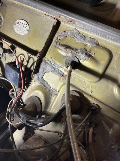

Removed the wideband and put some sealing were firewall was modified when they put in collapsable steering column, on the exhaust side I removed sensor and put a M18x1,5 stainless plug in from China.
Changed cooling fluid and cleaned the glassbottle bleeding al trapped air out, so now it should stand 25 minus degrees C. The studded wintertyres seem to work aswell holding air no vibrations etc..
Took a pic on my unortodox choke cable arrangement, not the way it´s designed to work but does the job greatly.

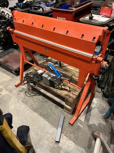

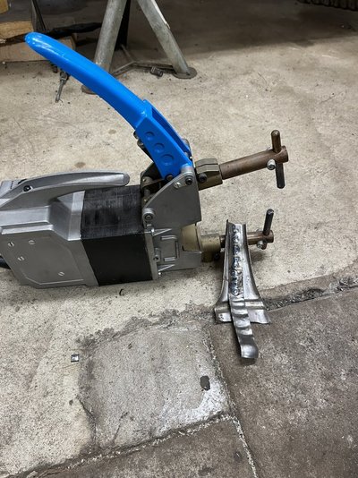

An update on my latest garage tools I bought, an almost unused old qulity spotwelder, tested and it works great, same with the sheet bender. Very happy with the new machines that was picked up with the GreenOne.

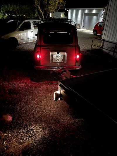

Studded tyres on the trailer, check all lighting and hopefullt the pair can make a 5-600km trip picking up a Porsche engine.

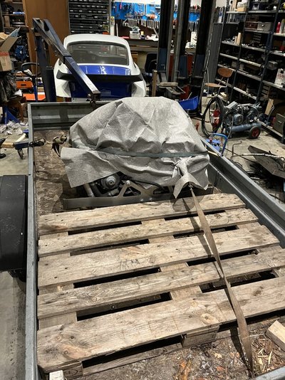

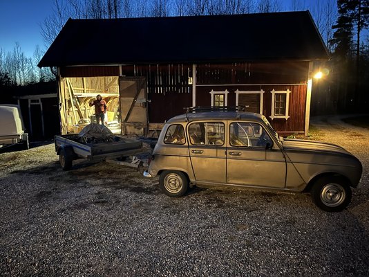

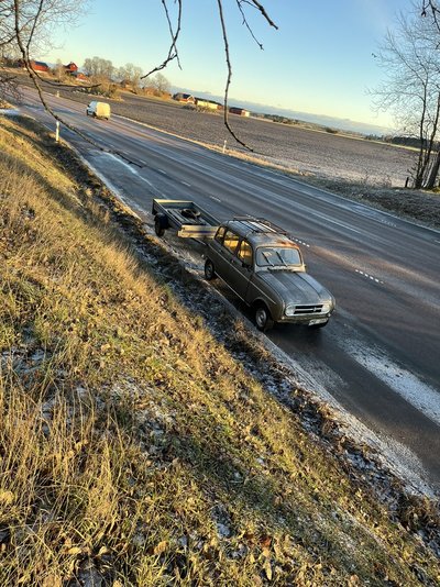

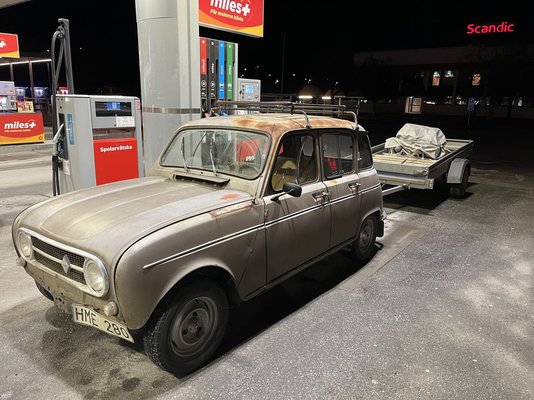

Yesterday was the big test. 500km (310miles) with trailer pick up a Porsche 996 turbo engine.
Car feels reliable new winter tyres all fluid under control etc, but this something else. 3-hours konstant driving (exept for pee paus).
The GreenOne was prepared with jars containing oil, coolant, petrol and coffe for the driver, as always my tool kit and drive belts to waterpump in the trunk. And for pick up i brought a pallet worn R4 tyre, a box ratchet straps, some fiber cloth and plastic to cover engine from dirt and debree.
Very happy that I installed working choke, car drives ok direct from cold. It´s the shortest day of the year today (vintersolståndet) and yeasterday was almost the same. I was really lucky, weather was on it´s best side sun from 8:45 sunrice till 14:45 sunset so all 6 houres with potential sun was sun.
The seller finnishes work early due to christmas so I was aiming to be there as early as possible aiming for 15:30 so left home 12:30 bit nervous but also faithful in the greenOne.
Can say people love the looks of a R4 with roof rack, specially when there is a trailer behind passing them :clapping:Cruising speed was 80-105km/h depending on up or downhill. Three hours later I was at sellers place -"**** this is KING" was his opening speach :laughing:
We already made up the deal last time i visited so it was a matter of loading eveything on trailer and inside the car. Put the engine centered on the trailer sitting on the R4 tyre ten som pieces of wood att strategically places in front and then rached with the straps then som dirt protection last handshake and home we go. First thing to do is to fill her up 260km on 20,1L E10 feels great (0.75L/10km).
With the preciuos load on the trailer we kept lawfully 80-90km/h on the way home sipping coffee from thermos, three hours plus later I was finally home. Almost exactly 7-hours and I am impressed with the comfort once you understand to sit like in a armchair instead of i car seat. Car has Canada heater so I didn´t even need to have fan on for keeping cabin warm, earlyer I had an opening in the fire wall due to lambda metering after I seald that off car became more quiet. The slower speed going home reveals in better fuel consumption even with 250kg extra load on the trailer.
Still problems with excessive engine case pressure. The 6-hours resulted in half a litre oilconsumption/blowby.:whistle:

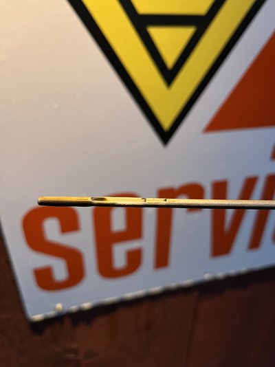

I wrote after my long trip (500km) that it had consumed 1/2 L oil on that trip. Checked my notes so have i topped up with 1/2L 10/60 oil once on a total of 3400km this year and still ok on the stick.

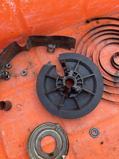

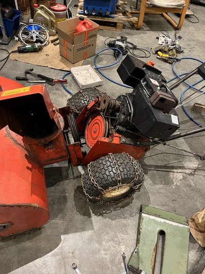

Today have been a sorting out day. Some TLC on the trailer before MOT. Rescrew the wooden flooring now third time and bigger washers every time, next time we have to replace the board I guess. Some corrosion on the brake light bulb. Winter tires sirted them self within the 500km trip. Every year we put them on one tyre av tiny leak between tire and rim. Guess the trim made a good seating cos it still was 2.5bar.
Next was changing belts on a snow mower I sorted for this year. Once I got the engine dialed in and carb settings ok, made an under tray that was missing etc etc. Ready for test drive the starter assembly disintegrated. Secondhand in USA was 150$ plus freight so I bought a universal from china 40€ freight included. Needed to extend the starter hub some lathe, pipe and welding it’s working as designed.

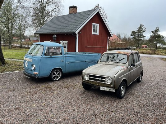

My friend Mats (he and I have slow car performance contests R4 vs T2) sorted some belts for me with his discount at work. When arriving ti collect them he had been out picking up some wood for carpentry with his really nice 1972 T2.
Belts in place and the everything adjusted snow mower ready for the winter.
Only problem it’s crazy big, so have to make a cover so it can be left outside.

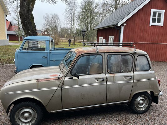

Have Skoda Felicia 1,2 as commuter car, need to have fuel economical car cos I got 120km back and forth to work.
Last night almost home my battery warning light came on. Put out high beem, fan, and heater on the seats and upend the speed considerably to get home on the charge in the battery. I got home YES.
Tiny oil leak dripping directly on the alternator and needs replacement or cleaning. GreenOne is stand in and ready for duty. I love this car, 20cm snow some minus degrees. Choke turn key and Wrooooooom nice. Put in reverse and the deep snow seems not be a challenge with the good snow tires on.
Probably GreenOne have to be my commuter next week 500km, so roof rack went off it’s both a snow trap and bad for fuel economy.
15 minutes later it is ready.

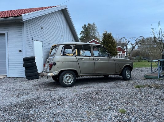

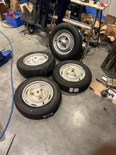

Always time optimistic!

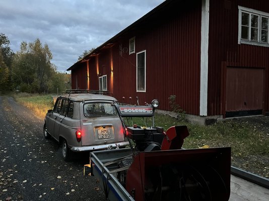

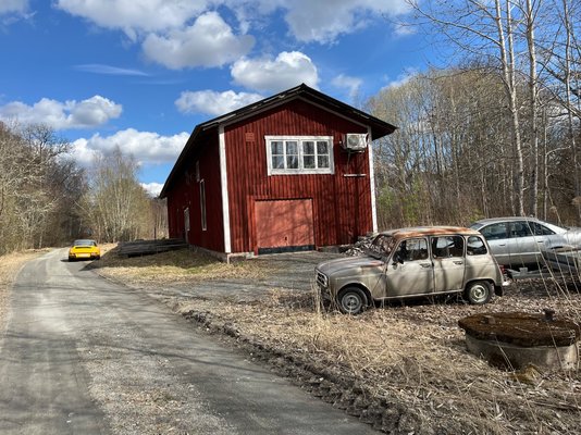

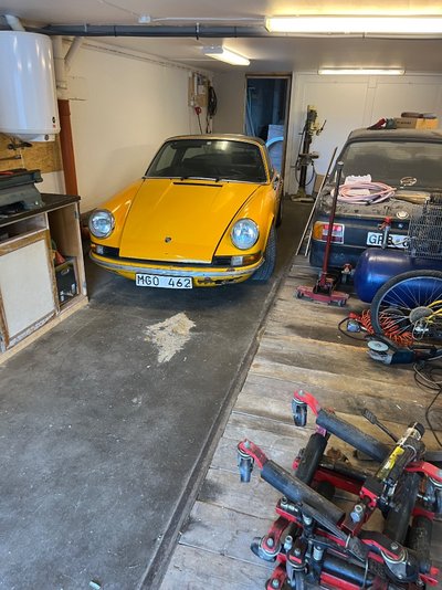

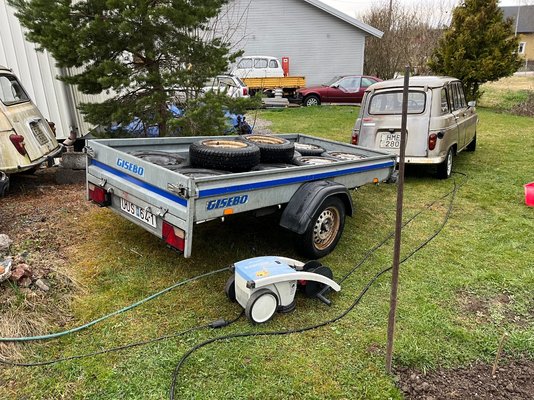

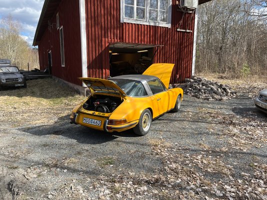

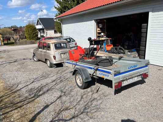

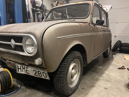

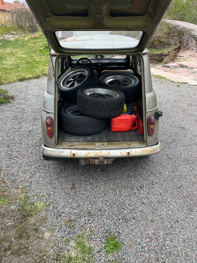

Plan was to sandblast and paint some rims white before i put on new old tyres in dimensions135/80-13. Instead I pick a set of four with somewhat similar appearance. Take of old tyres and tubes, wire brush contact point for tyre and valve. New valve (instead of tube) and tubeless tyres on the rim. Nice to have a tyre machine in house, mount "new" tyres. Overinflated to 2.8bar (to reduce roll losses).
Have changed all my cars and trailers from studded tyres to summer tyres.

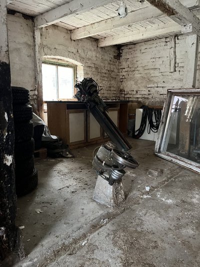

Also time to pick up my 1972 Targa from train garage place and put snowblower there instead.

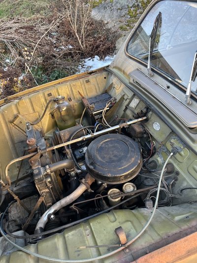

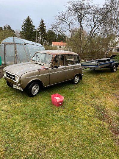

After excellent duty on the winter GreenOne got a very well deserved spring wash.
First my Kransle pressure washer needed some attention. Dismantling and cleaning all valves and filters inside the pump washer was back in business (last year I had no time to give it a service).
I collect rainwater for my crops and also use it for washing cars.
Gave it a good pressure wash under, wheel wells, engine room, and were body and chassis are meeting.
Of course the body also get some Kransle treatment.
Then she got a handwash or two to get rid of all salty filthy stuff Swedish winter roads offer.
Father trailer got same treat as winter wheels from my winter cars.
Clean and ready for next winter they got to my storage at fathers place.

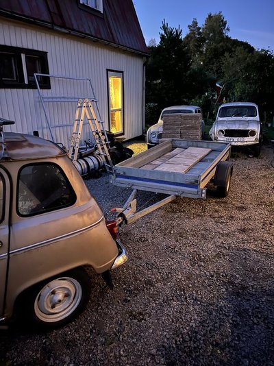

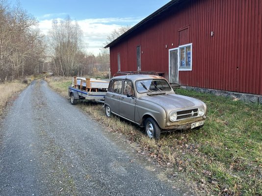

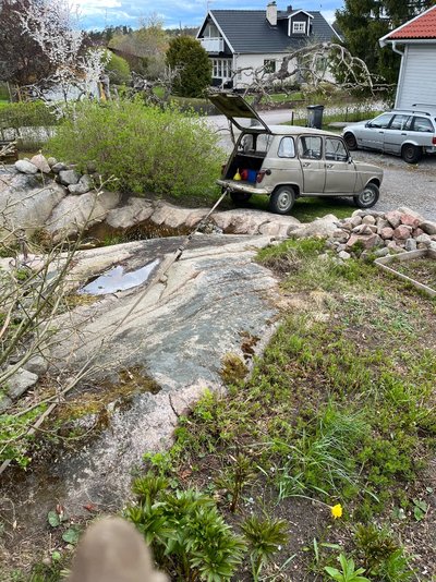

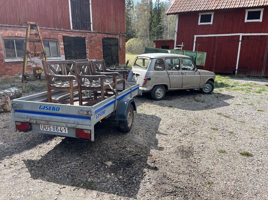

GreenOne have been a daily driver since some weeks, also gets me to work 120km/day. With the new summer tyres (2.8 bar) and fresh lubrication in the driveshafts shes a smooth ride. Have also start driving a bit slower, now she takes 5.5-6.5L/10km. 8000km since I built the engine so its time for some oil service shortly.
As usual work horse there been some outdoors furniture picked up from storage. Been to the yearly car parts market, bought a lots of mandrel bent exhaust piping, two hammers and a divider head for my milling machine. Season for Porsche autocross have also started so wheel and other stuff have been transported as well, this year my sons Boxter needed some assistance from the Beast.

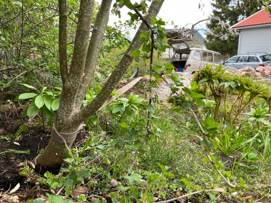

Latest car was anchor while remove a tree in the garden. Two ratchet strap between the tree/bush and to the tow, pre tension then manually lift in the middle of the strap, shorten pre tension and repeat soon tree came up with roots and everything.
