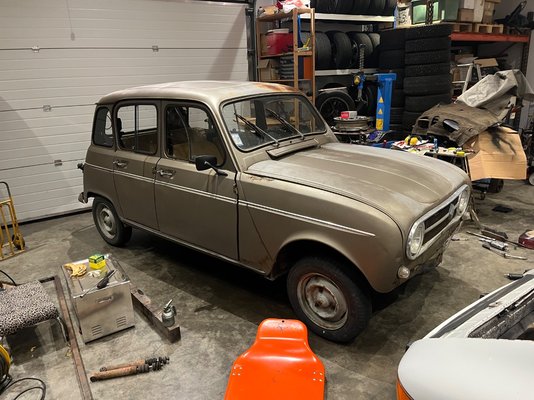

Homegrown Garage Green One -75
I like seeing these pictures because an R4 is a real workhorse and jack of all trades.
Reminds me of how I drove my first R4, commuting distance was 200 km per day and then all the other kilometers. Parachutes in the back and everywhere through Europe to airports for skydiving and objects for BASE-jumping.
Keep up the good work

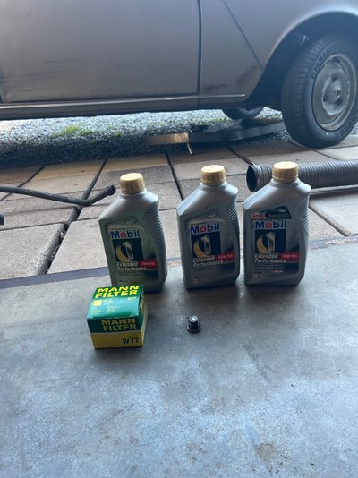

10000km since engine rebuild so first oil service. This time she got 2L 15-50 Mobil1 fully synthetic (from the time Mobil1 was best), and one bottle in the car for fill up.
Seems like my homemade magnetic oil plug made a great job, there was some magnetic slurry on it when I drained the oil ( probably from the new piston rings). Took the slurry between my fingers and nothing big enough so I could feel it .
New Mann filter was also in the deal.
Otherwise GreenOne behaves great 7000km this year without any big hiccups.
Hade to replace clutch wire and rebuild some because it has a square box and wire was for round gearbox.
I also grease the driveshafts when needed.
Today she was tool carrier when I helped my father fix his tractor.

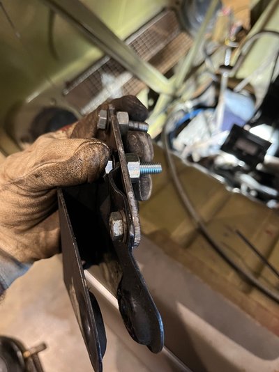

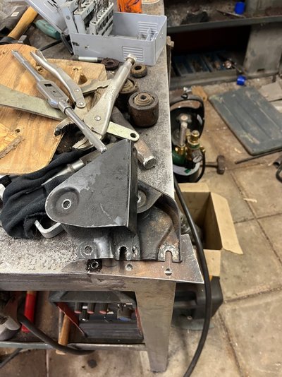

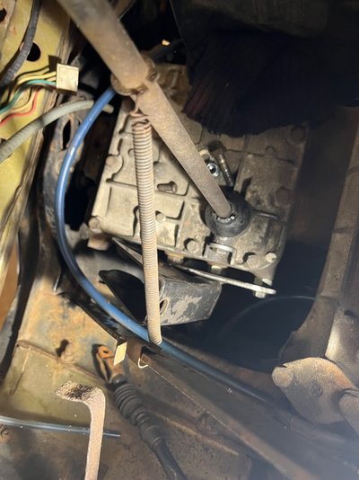

In august clutch cable said i don’t want to serve you anymore.
Took me home starting on first gear and clutch less shifting to fourth gear.

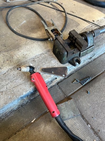

Could only find clutch cables in france (sheep but high freight cost) cos my car have square box and long clutch cable, round gearbox have other hole spacing and different position so I made an steel adapter so i could use round box cable and lever mechanism. IMG_3171.jpegAdapter on the gearbox

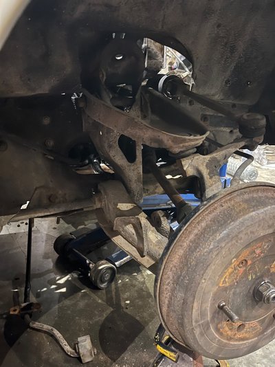

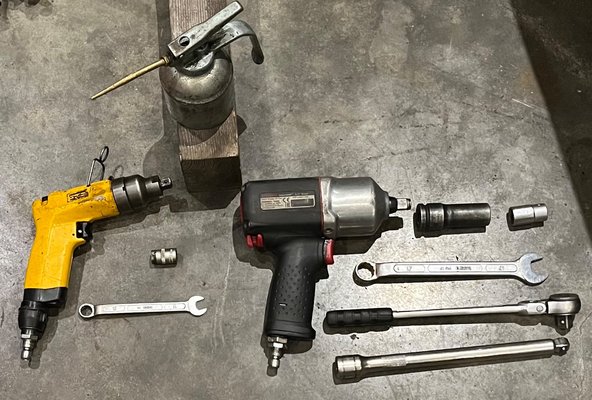

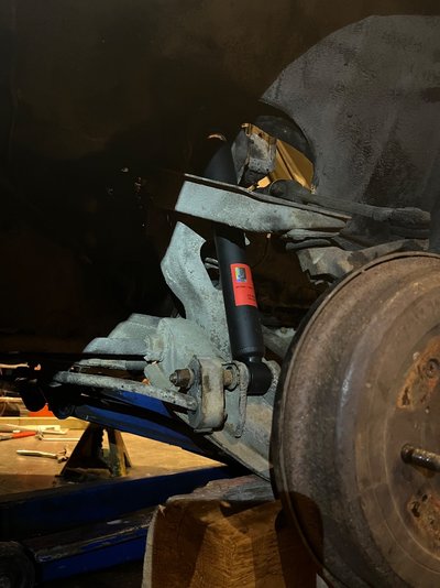

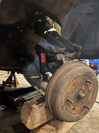

Anyhow I bought a lot of spares to the R4s some years back. Now I start put on new front shocks. TWR from Autodoc. Dampers I replaced was red (maybe Koni), not totally shot so I keep them as spare.
Haven’t tested them yet other than rock car on garage floor and that seems good anyway.
Very quick and straightforward to change front shocks.
Tools used:
Car jack, jack stands, 3/8” and 1/2” air wrenches, 17mm socket, 17mm wrench for wheels, lower and upper damper nuts and bolts. 11mm socket and 11 mm wrench to remove the swaybar. And when mounting new dampers top nuts was 14mm.

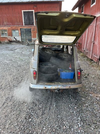

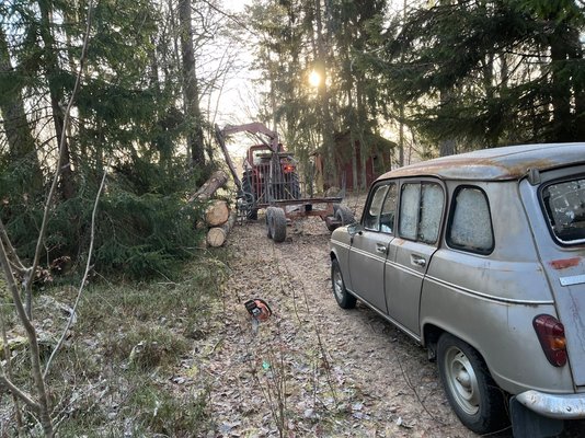

Needed to go terrain driving since my fathers “logg trailer” broke down in the woods. The boggie had fallen off the frame, so trailer hang behind the tractor fully loaded with loggs and no wheels.
I brought some tools, coffee, brain and muscle.
One hour later loggs was unloaded and boggie back on the trailer, reload an drive home.
Actually very impressed by the capacity in terrain can’t compare with my Niva but no new cars had been able to get all way to the tractor.
Let of some summer tires when I was passing.
