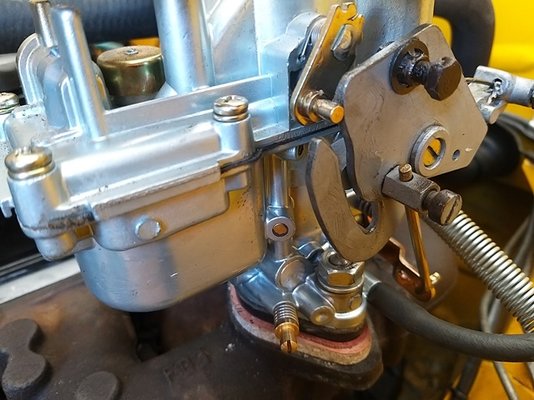

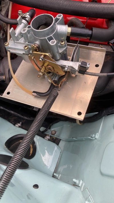

I made up a generous heat shield to experiment with and placed it between the manifold and the carburettor. I took the car for a spin round the block and then left the car with the bonnet shut to see what would happen. Turns out the problem is still manifest. The carburettor body was quite cool but the fuel in the pot was still boiling vapour was escaping and fuel was being pushed over the overflow clearly this is a dangerous state and I can’t allow this to continue. On my car, the fuel filter is on top of the engine. And I think this is where the majority of the heat is being collected so my plan is to fit an electric fuel pump and place it away from the engine itself then run the fuel pipe away from the engine up to the carburettor via a fuel filter

Yes the air filter is not fitted in this photo so you can see what I meant by heat shield
. Air filter was re-fitted all exactly as normal but still big problem

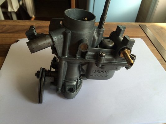

Note the brass/silver dome riveted in place at the top of this original Zenith 281F which I believe acts as a breather for the float chamber.

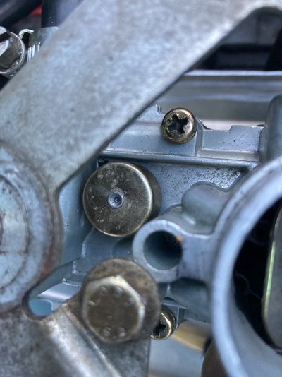

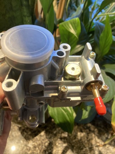

Yes fuel is boiling and yes it is a breather as you say - I have just checked and it does have a breather cap
The carb I have been using is good quality repro - very very similar to the original 28if

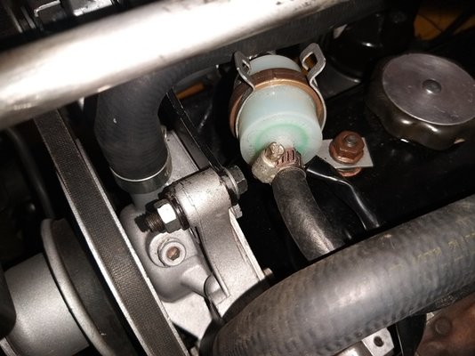

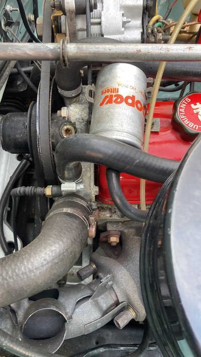

The fuel is clearly hot as it comes into the chamber - so I’m pretty convinced there are several things happening but the worst contributor beyond the moder fuel itself is the filter on top of the rocker box
I was wondering about that strange huge metal fuel filter as well ? Metal retains the heat, so I would change it for the smaller plastic see through original type. So you can see the fuel flowing. We use Shell 98 (Ethanol free) in Classic cars over here.20240416_081952.jpg
I was wondering about that strange huge metal fuel filter as well ? Metal retains the heat, so I would change it for the smaller plastic see through original type. So you can see the fuel flowing. We use Shell 98 (Ethanol free) in Classic cars over here.View attachment 32979
Jjad Nice to be in contact again yes I agree with your point re plastic. I think however if you had ethanol in your fuel you might suffer too
I have a small plastic filter on order

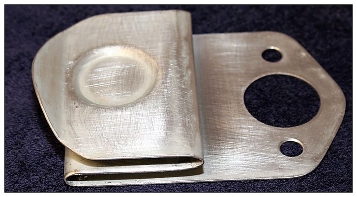

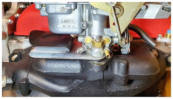

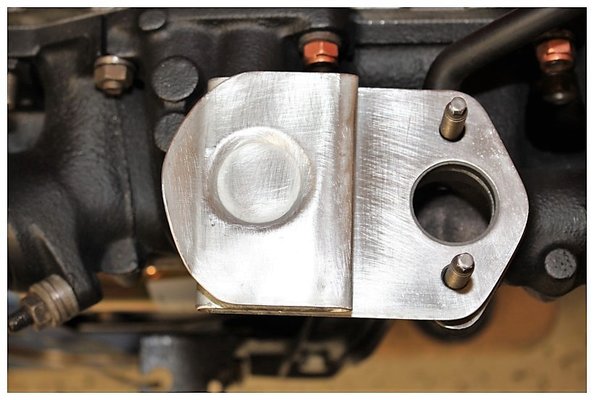

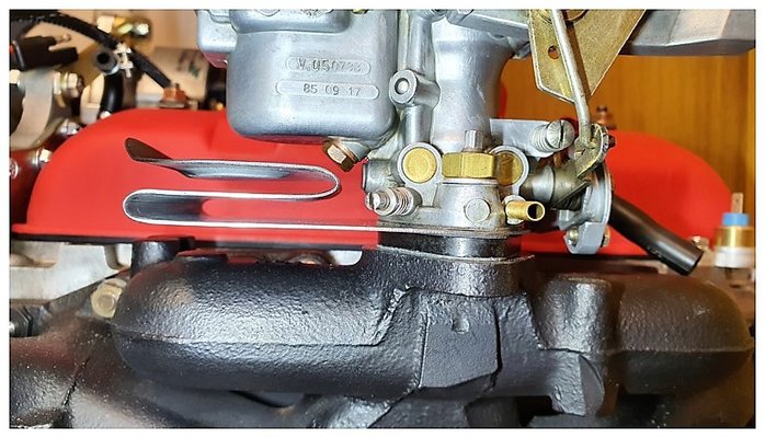

The R4 GTL with Zenith carb has indeed a history with hot (re)starts, even the Hayes mentioned a modification regarding fuelpump and fuel lines.
Also I came once accross an article regarding a combination of heatshield and real ceramic coated manifold.
A single sheet of metal is not really a heatshield, it must consist of several layers to radiate the heat.
I don't have experience with the Chinese :vsad: remake Zenith but on several forums (Netherlands as well as this forum) people are not really convinced.

I really like your design and agree a layered approach would be best
My attempt was a first experiment and it is currently fouling the accelerator cam on flat out .
I will remodel incorporating a layered approach
I have seen modern exhausts wrapped with a crinkly aluminium sheet - the extra surface area must help
