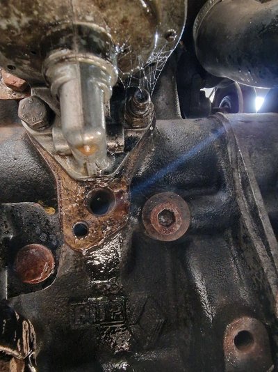

politeperson The restorator Messages 159 Location Boston Jul 22, 2022 #1 I managed to get my 1108cc engine running, first time in 20 years. Sounds very nice. However, oil is pumping out from a hole below the fuel pump! Any idea what is missing? A spacer plate? A blanking plate perhaps? Please. James
malcolm & Clementine the Cat Messages 4,615 Location Bedford UK Jul 22, 2022 #2 You are missing the mounting plate. The photo in this thread has a very good picture of the mounting plate: https://www.renault4.co.uk/forum/threads/does-my-r4-have-a-r4-engine-confused-now.1413/ It is secured with a bolt in the bottom hole.
politeperson The restorator Messages 159 Location Boston Jul 22, 2022 #3 Ah, thanks Malcolm. As it seems to pump fuel, I will knock up a "mini blanking plate" tomorrow and bolt/ glue it in place so testing can continue. In the meantime, if anyone has a mounting plate please sell it to me! James
