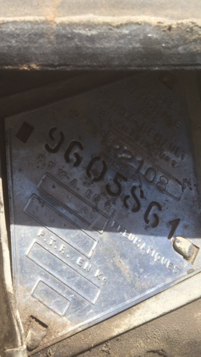

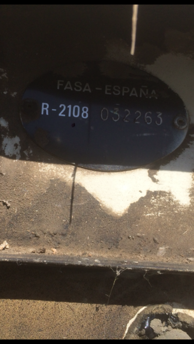

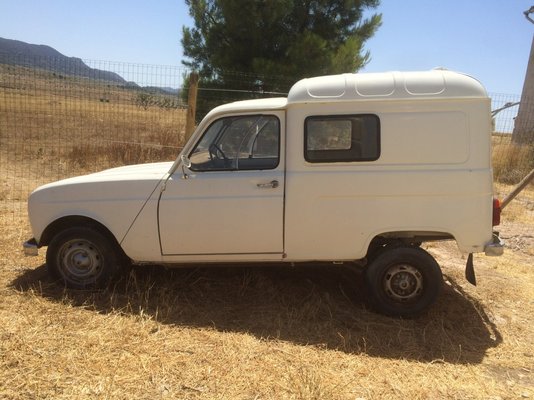

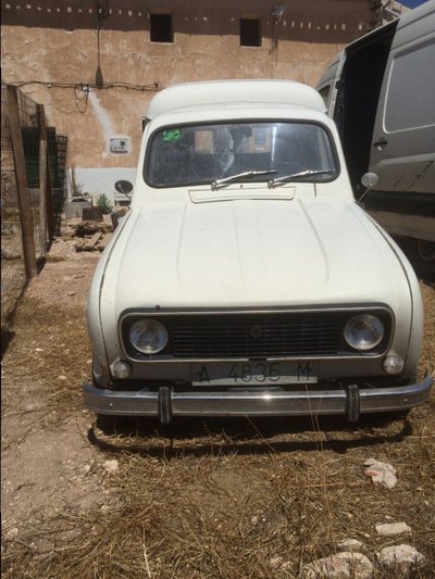

According to the table in Parts Book PR 1104, vehicle R 2108 032263 would be from 1972 (the year R2108s were introduced). The black plastic radiator grille looks 80s, but judging by the hinged front air vent (as #Leonardo.IT says), round indicator lights on the bonnet, circular wing mirrors and the old-style front bumper this is obviously an early 70s model. If you have the original air filter, sometimes the date is painted inside this (under where the filter element sits).
Our car which is a 72 model 1126 782 cc has the small round indicators, has no secondaries on the wings, has the painted vent, and has the Mk2 chrome grille. So this is later than that, because the plastic grille came in September 1974. Black plastic vent flap came in july 77. So the window is Sept 74 - July 77. Then there is any modification for it being Spanish
