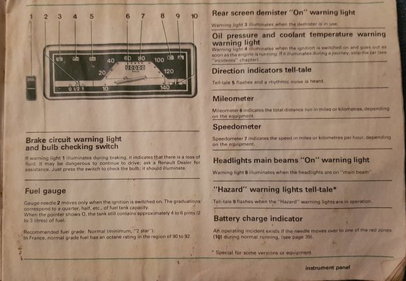

Since the engine rebuild, I've lost lots of functionality and am in the absence of the owners handbook, I'm looking for an explanation of the lights within the instrument cluster so that I can get started. I have a Haynes manual, which only appears to deal with the later style instrument panel.

What's not working? When you switch on the ignition the oil pressure lamp should light up. If it doesn't you need to find out why, since you'll have no warning should you lose oil pressure, the results of which would be catastrophic! The battery meter should sit in the green zone in the middle, and not swing into the red zones; is this behaving itself? The green indicator light should flash when the indicators do-it's an M.O.T. fail if it doesn't. Loads of advice here if you need it!

It was all working fine until the engine rebuild, now lights, indicators, heater switch etc are all no longer working. At start up, the lights do come on and I knew that one of them was oil pressure so all good there.
