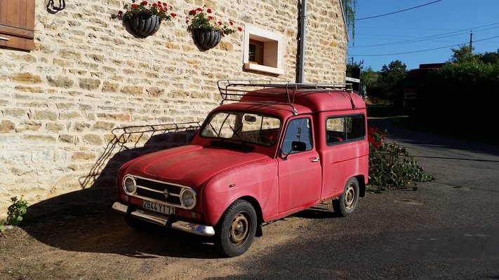

I've ordered a new chassis for the F4 van!
malcolm
& Clementine the Cat
4,621
Bedford UK
The process for ordering a chassis from Melun Retro Passion used to involve learning French and phoning them up for a transport price in the polite French manner. I didn't have any luck using Google translate and email.
I notice the website has changed and there is now an option to buy and pay for the chassis and find out what the transport cost is later. I've just done exactly that (using Paypal just in case). I will let you know the process and costs should it all go well.
Hopefully the wonderful Claude Van-Rouge will return to the road with the new chassis. I miss Claude - he was so useful. I've got a plan to build a workshop quickly for the chassis swap.

It'll be cool to get the van going again. I'm planning to attempt to keep the faded paint and scruffy patina which would mean careful welded repairs to retain the front inner and outer wings. Will need to think about how to best preserve the rare optional rough road sump and fuel tank guards. Might paint them.
