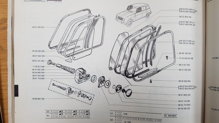

In the pic, with the right hand closer group, i can see the darker curved piece which appears to be the channel that holds the fixed front pane. So is it the further frame between the two glass pieces that is the runner for the sliding glass?

Yes, the innermost frame is the sliding glass frame; the outermost the fixed glass frame, but the whole thing operates as one unit (it's a long time since I've taken a metal window frame apart, though). I haven't been able to track down replacement parts for the frames - I imagine there's quite a lot of competition for them!.
You can get the chrome parts (both sides) here:
https://piezasautosclasicos.com/catalogsearch/result/?q=0428293100
There's a genuine N/S one on eBay:
https://www.ebay.co.uk/itm/PROFILO-...906463?hash=item5473042d5f:g:VxYAAOSwJtJb99Xx
This might be useful too (the dimensions look right, but it's worth double-checking with Der Franzose):
https://www.franzose.de/en/Renault/R4/Tuerscheiben-Anbauteile/ANR87315/
Useful bits here too:
https://www.palace-de-lancienne.com/vitrage/
