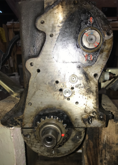

It looks like that rust has eaten away the metal in combination with poor oil, lack of oil changes, leaking piston liner seals, and years of standing in a barn. In general overall lack of maintenance (oil, cooling liquid) judging by the sludge build up on the outside of the pistonliners.
Do as @mojobaby suggested, all the oil feed channels have to be cleaned, the oil pump as well, remove the camshaft also, dismantle and clean the rocker armshaft assembly etc.
@Jurjenz project is a good example and there are more good examples because they handle the Billancourt engine, for me, I am a Cleon engine fan.
But the type of engine doen't matter, it's the final result that counts and that will cost time, a bit of £££, patience and a lot of reading in the correct manuals because Haynes doen't cover all the bits.
