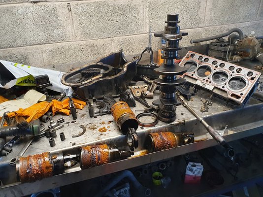

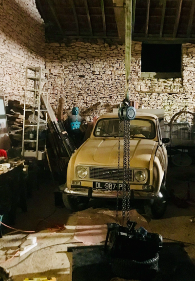

pistons wouldn't lift out of the top, the lower lug catches so decided to tale the whole lot out might as well go the whole hog eh! Screenshot 2019-10-01 at 21.56.58.png Screenshot 2019-10-01 at 21.56.58.png

And I thought my Cleon engine was a sludge bucket but your Billancourt is in the lead :D
Get that engine out and do a complete refurbish, there's a lot to be found on engine refurbishing in the projects section.
Good luck.

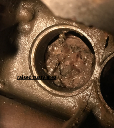

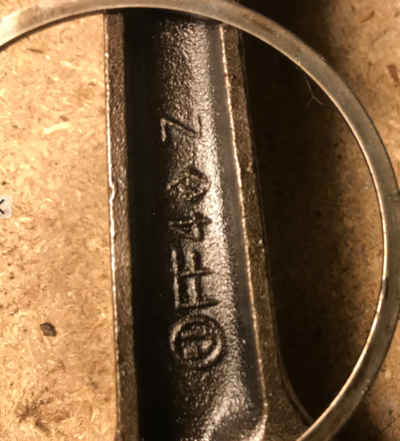

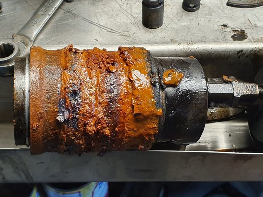

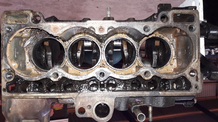

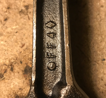

did some work over the weekend, all pistons & sleeves out..all have FF4 but one, number 4 has FF4 7..see photos. It was this piston catching & I think the problem (maybe) rust inside the block (see label in photo) had made the liner move slightly (paper seals worn away & it caught at low revs, there is a slight area of roughness halfway up the lines (not much though) other than that all rings are in tact & not bad condition, I will put new ones in though! Does this sound like a plausible explanation, it was basically kind of catching at low revs & wouldn't idle smoothly.

Impressive shed you have.
You have to make do with the possibility’s you have.
The liner seat looks quite good.
Keep it clean. The smallest blemish wil make it leak.
A sure way to seal it, is to pour some thinned down paint in between the liners and let it dry before you put the head back on.
Good luck on your project.
You are on right track.

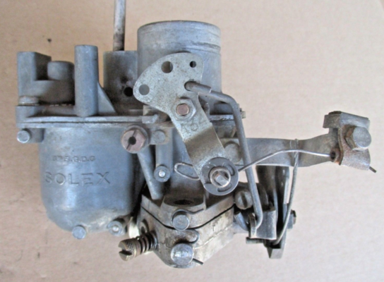

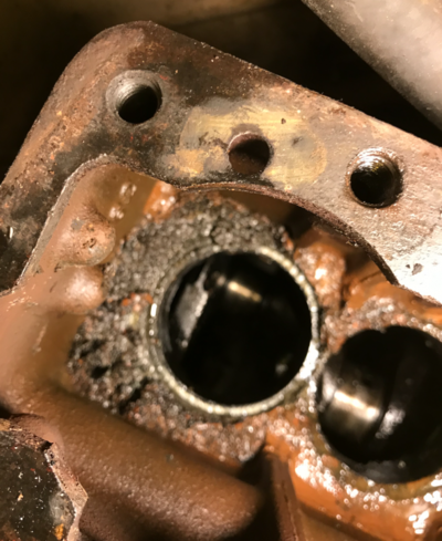

Thank you for the kind comments & advice, the spare engine I bought came with the normal zenith carb but he also gave me a cute little Solex one, like this photo I recall you mentioning these carbs Harbourseal, on a thread saying they were good, do you know what engine they go with? thanks

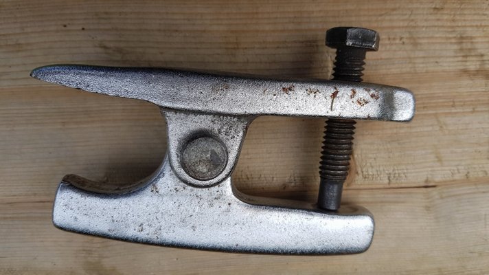

oh blimey! I think I'm going to try & do it with the block in this time although haynes describe getting the sump back on as one of the worst jobs on a R4!! I don't have a ball joint splitter thingy or some other tool required either!!

I would make every effort possible to remove the engine from the car at this stage, just for (correctly) refitting and resealing the sump. If you are lucky you will be able to get the ball joints off without a splitter, apart from this no other special tool needed.

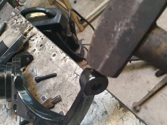

Use hammer, hit it couple of times in place shown on the picture, and the trackrod will pop out , do not hit the thread.

thanks for advice, ok I'm going to go for it & get the engine out I'll try find a ball joint splitter..google translate permitting! I'll prob do a much better job of fitting the pistons & getting the block cleaned up too.
