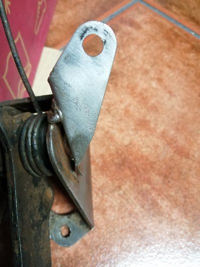

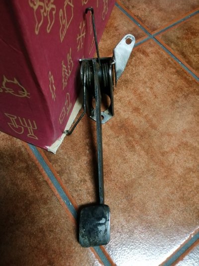

It so happens that my clutch pedal's spring is broken and I need to replace it. I dismantled the hole thing, including the wall plaque where the pedal support, plus the master brake cylinder, are bolted to but I've come to a stop!
After dismantling the clutch pedal, I cant seem to figure out how to dismantle the brake pedal structure, where the clutch and brake springs go.
Can anyone help me?
The clutch pedal bush / brake pedal pin holds the rest of the assembly on the pedal bracket and it has to be pressed out. It's not an "official" procedure, the bracket, brake pedal and both springs were sold as an assembly when something would need replacement. Better leave it as it is live with this, unless you have access to an hydraulic press.

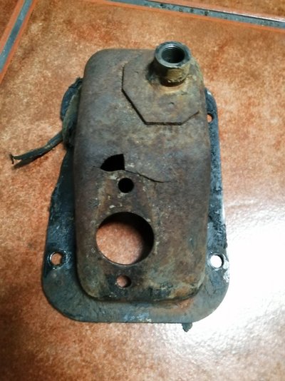

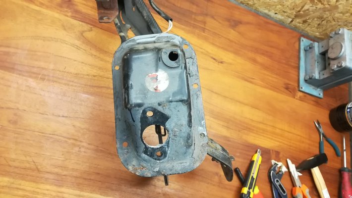

By the way, the steel housing to witch the pedal structure and master brake cylinder are attached to is beyond repair. Do you know where I can buy this particular item?

Some pics of the mentioned items...

It's very common for the pedal bracket mounting to fail like this on high mileage cars.
The part Jurgenz has is late pattern, and will not fit on your bulkhead.

Drop in just to say that I managed to buy a second hand part from a car parts dealer here in Portugal, in poor status but, never the less, better than my own. Expensive, though - 150€, with a good clean over and paint job to be done...
Waiting for delivery. So it seams I'm on the clear, as far as dodging this "bullet".
