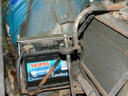

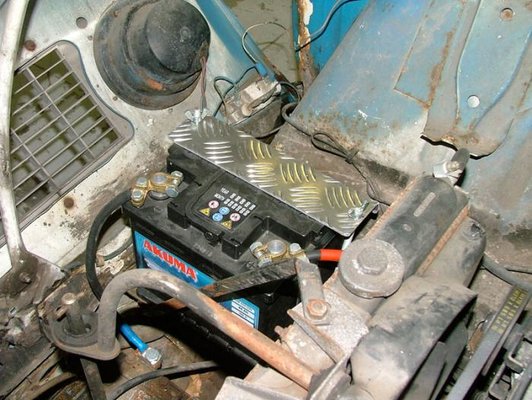

Hi, you can fit there so big battery as possible. You are limited by the space and by the battery price, because the bigger capacity the more expansive battery. I fitted the 44 Ah battery, you can see the pictures.
Greetings from Prague Pavel :)
