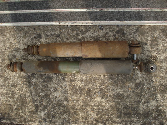

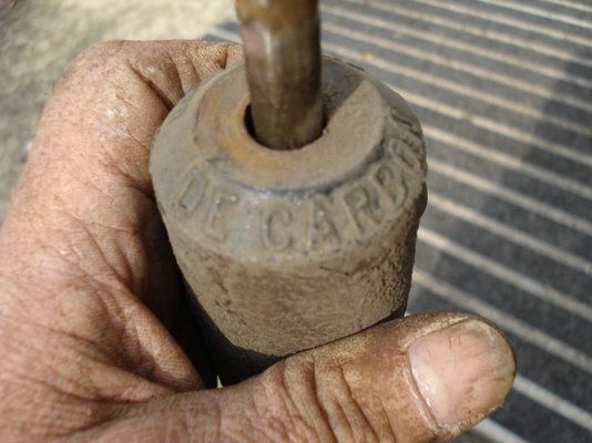

Took the shockers off when sorting the rot out on the back end.
One shocker came off easily, the other was fun- it was under compression, and expanded after removal.
This rather active little bugger had 'de Carbon on it...an original?
The shorter one sort of works as a shocker-0 you can move it in and out by hand, and you get a gurgling.....
Is this a problem or should I just get a new pair, and if so, where from?

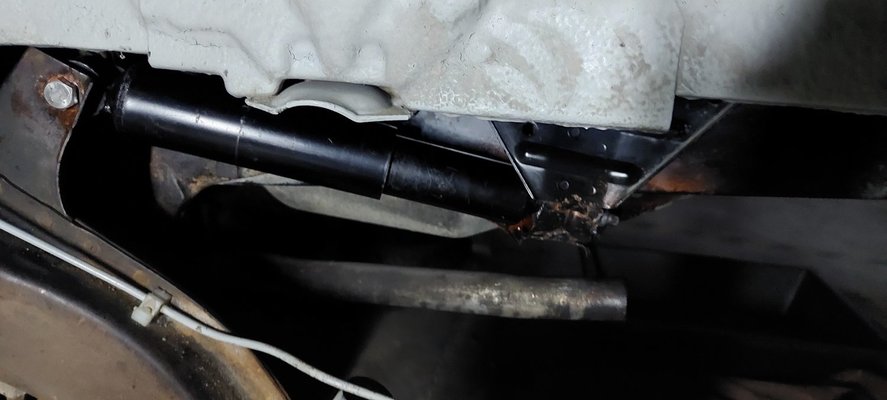

Shockers arrived and fitted!
Took three attempts each side and all of my strength to fit them ...I have the feeling the back end won't be so bouncy now....!
@Andy McGhee how many washers did you install with the monroe? I bought an pair of rear monroe shock absovers and only get 2 washers per side.

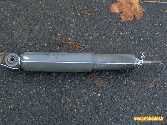

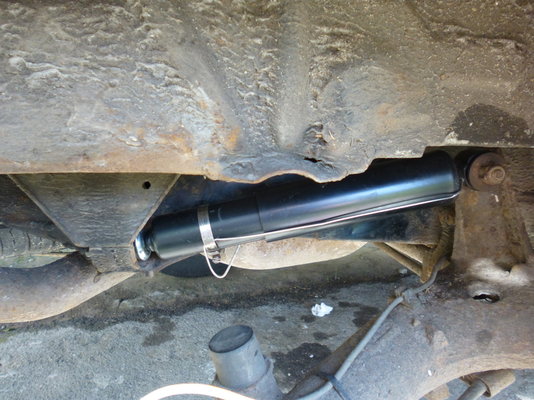

I can't remember - it was quite a few years ago! I remember using an old bicycle spoke and a worm-drive clip to hold the gas shock together, though.

Thanks a lot for your share. I will try put the original set.. but probably with the new rubbers(i don't know the dimensions of the originals) is not possible

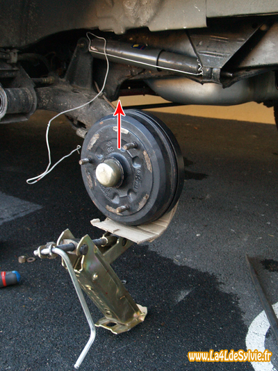

Compress the shock absorber and use a piece of rope to prevent it from relaxing (new shock absorbers usually have a rod).
Place the shock absorber in place by lifting the suspension arm using a jack if necessary then tighten the nut and the lock nut of the lower axle then the bolt of the upper axle (if possible, think to lubricate the upper axle in order to facilitate future disassembly). Finally remove the flange and let the shock absorber relax.
Caution: to tighten the upper axle of the shock absorber, the shock absorber arm must be in the “half-load” position. Basically the shock absorber arm should not be completely relaxed but not too raised either.

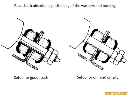

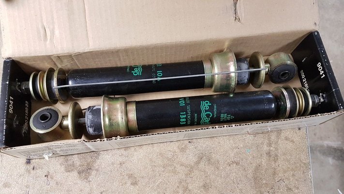

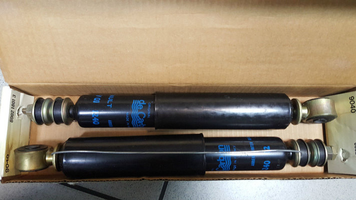

Originally there should be 3 washers (3 for the front and max 4 for the rear) as the original de Carbon do have them like mine de Carbon front and rear NOS shocks,
They are still available but very rare.

Thanks for your share @JdeW . Your shock absorber photo had help me.
Real this work is not so easy than I thought..

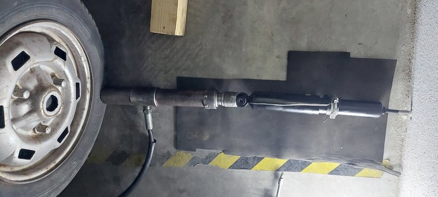

I don't have photos how I compressed the shocker but alone was the only way how to.. the right side is done.. I installed 4 washers like I was installed before.
