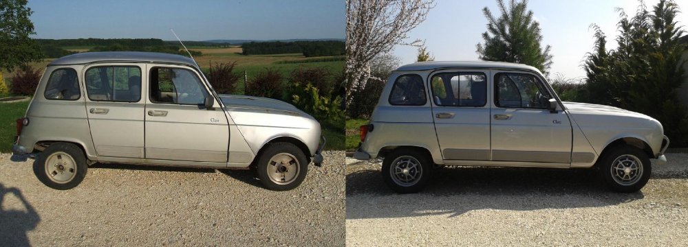

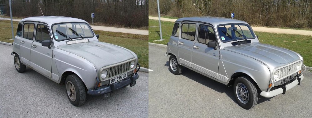

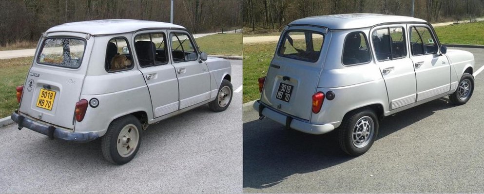

sunday morning I went to the exact place where I took picutres of the car before its restoration. It runs really like a new one but there is ONE problem, even I tried to do it the best I could, the front axle is not adjusted and the driving is absolutly horrible with strange and frightening reactions in the steering wheel :confused: :confused: You can now compare Before and After...
It was really moving to be here where I was exactly fiver years sooner, especially because at the time my friend Snoopy was still there :( :(
