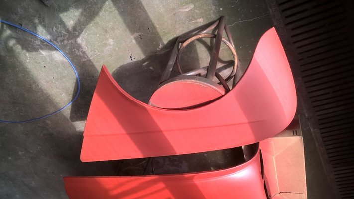

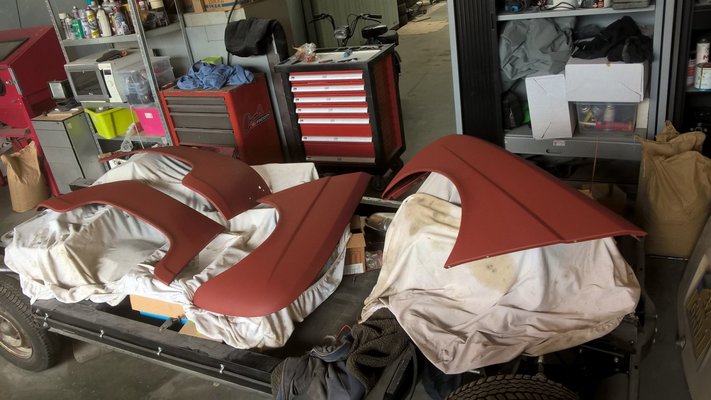

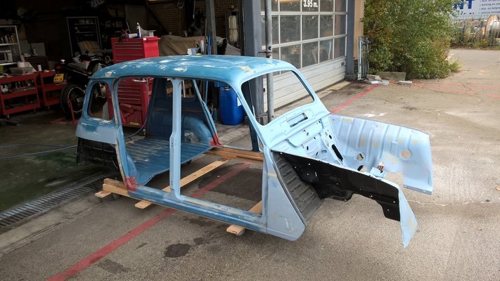

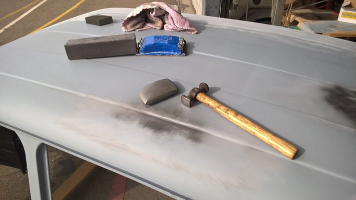

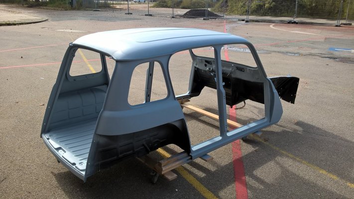

Pffffffff, spend another six hours on the hood, but I'm almost there! I had to do it all over again to get the larger dents out.
Next, sanding with 400 grit, and 2k primer. It is going to be mirror smooth!!
Thanks!

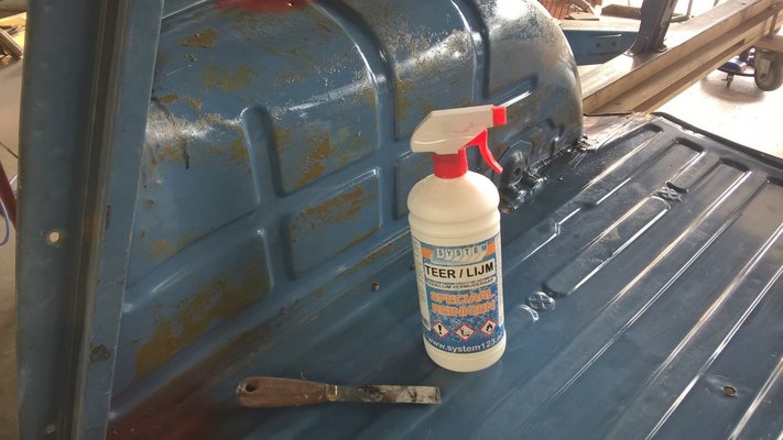

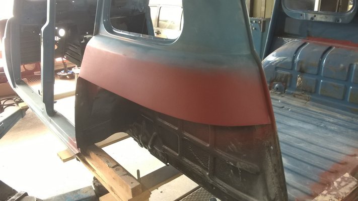

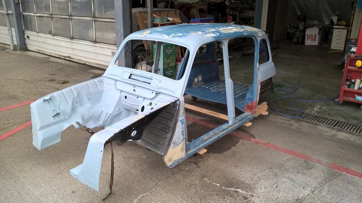

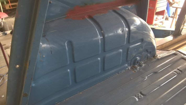

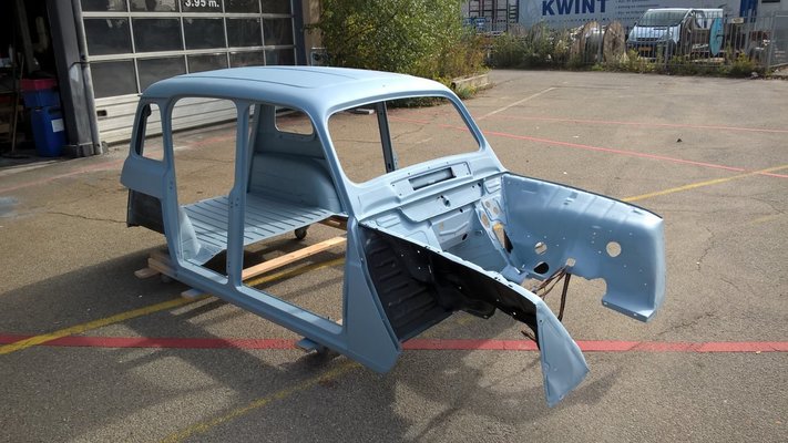

I removed the glue residue on the rear wheelarches:

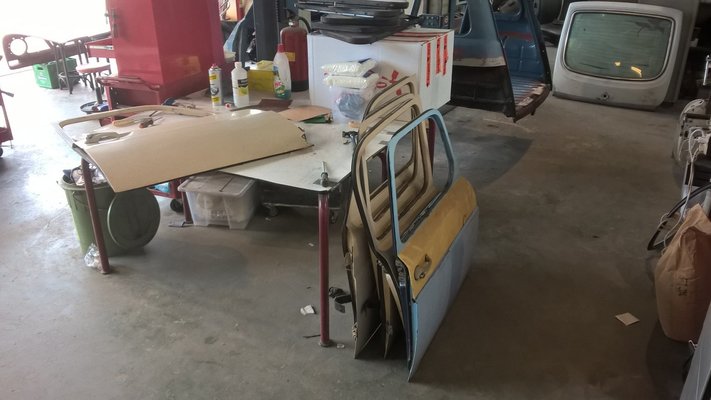

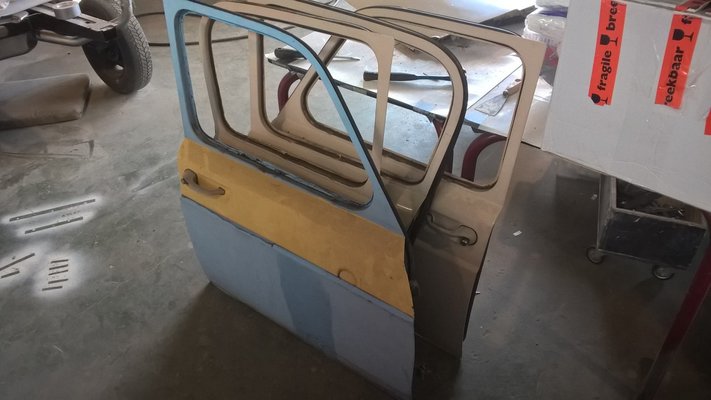

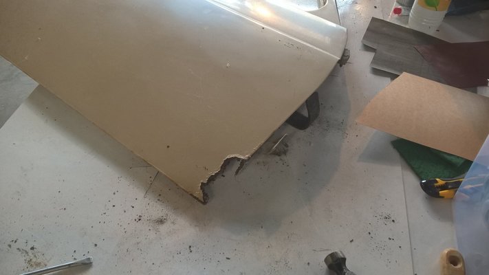

Then I disassembled the doors & parts
Can't use this one..

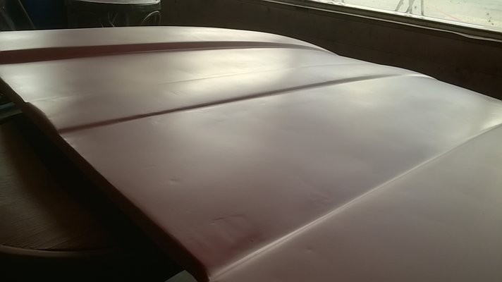

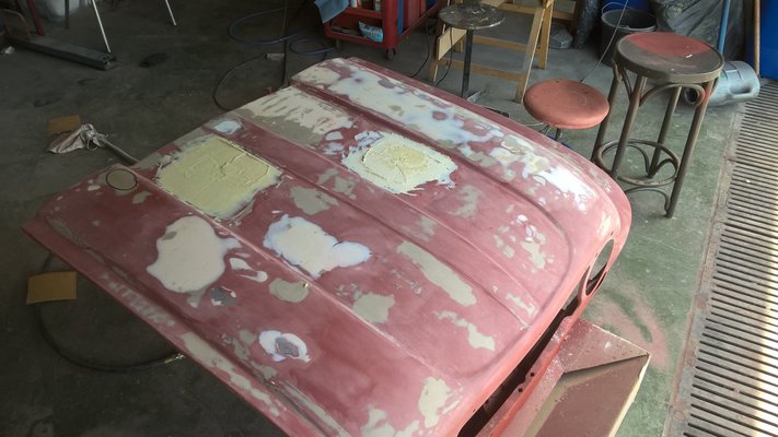

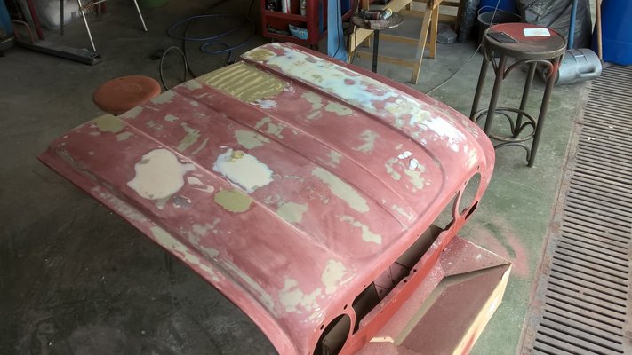

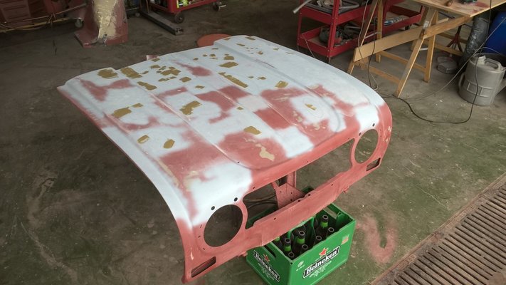

Once I finished this, I started (again) on the hood:

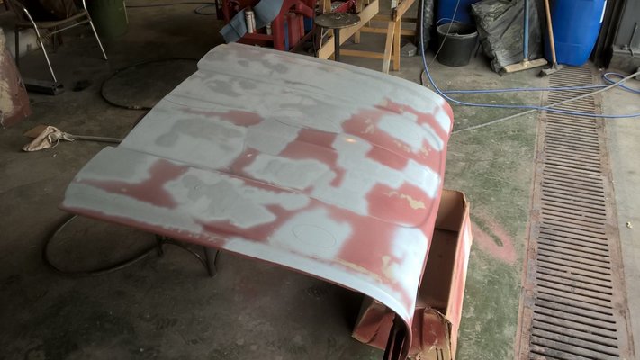

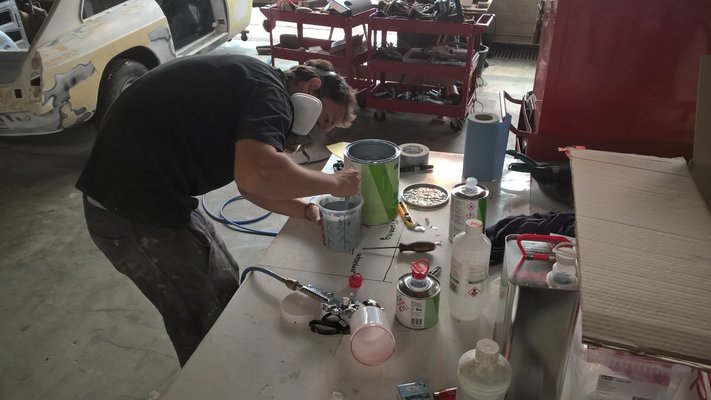

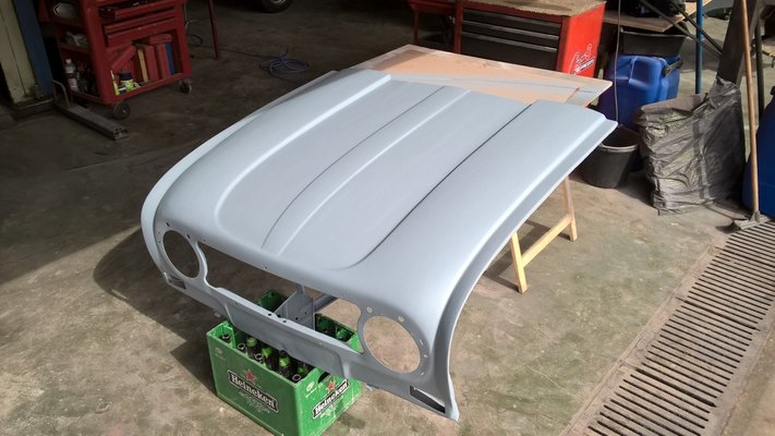

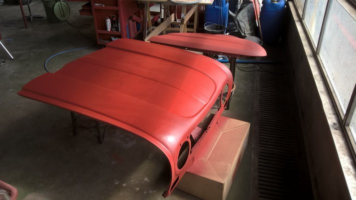

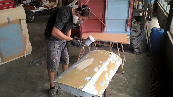

Once I sanded down this filler, me and my buddy (Dick) started mixing the primer and started with priming the hood, and the MG doors
Below, Dick spraying his doors
No dents visible & notable! Yeahh!!!!

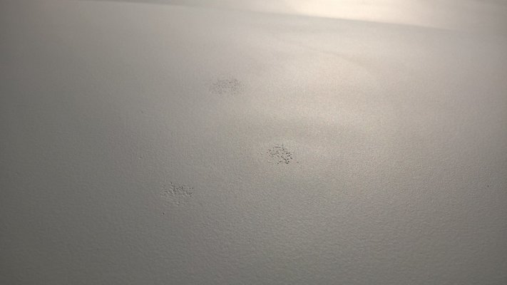

But, they're are still some minor spots to work on, then I will wetsand it for the last time... Nearly there!
Need to use some fine filler to fill up these little holes.
In the end, it was a hardcore job to get the hood smooth, but it was a very rewarding experience - 'learning by doing'. Would I do it all over again? Hell no, instead I would be buying a new hood. :whistle::waving: I spent almost 16 hours on it..

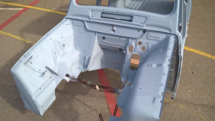

Next job, priming the motor compartment & order paint (base coat).

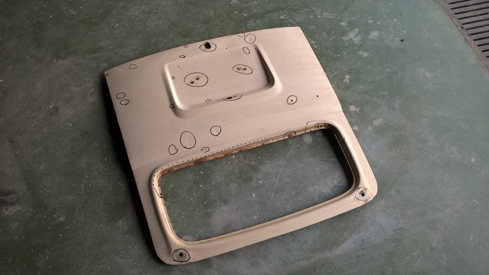

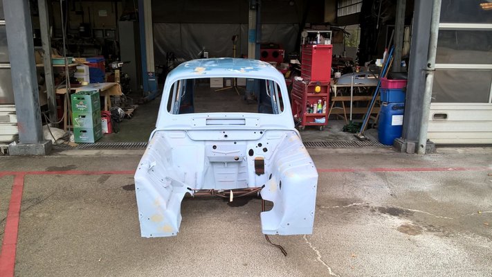

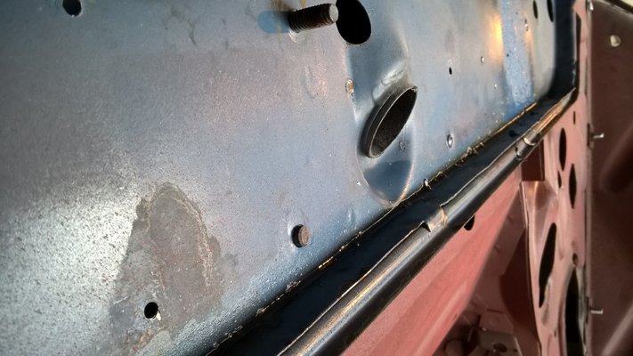

Removed all the bits & parts on the rear door and marked the areas which neef attention..

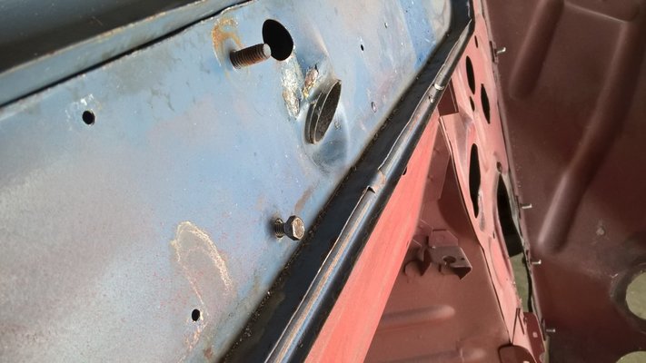

Broken bolt on body (hood lever), fixed it with a helicoil. Let's say, it does the job..

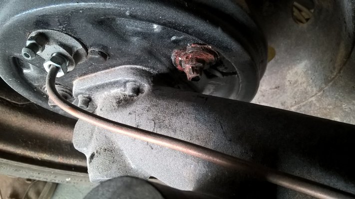

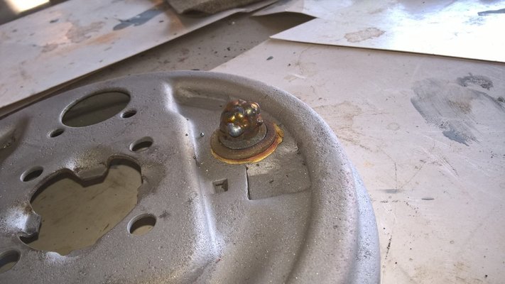

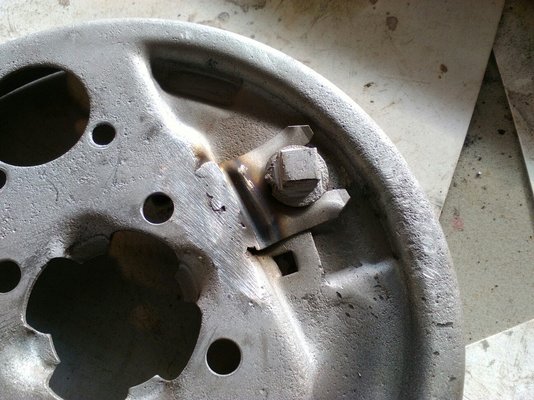

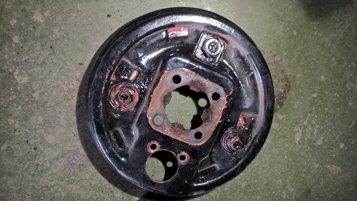

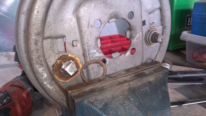

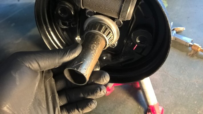

This I postponed for a very long time. A rusted & broken down rear brake adjustment bolt. It was previously damaged by an vice grip. Well, here we go..

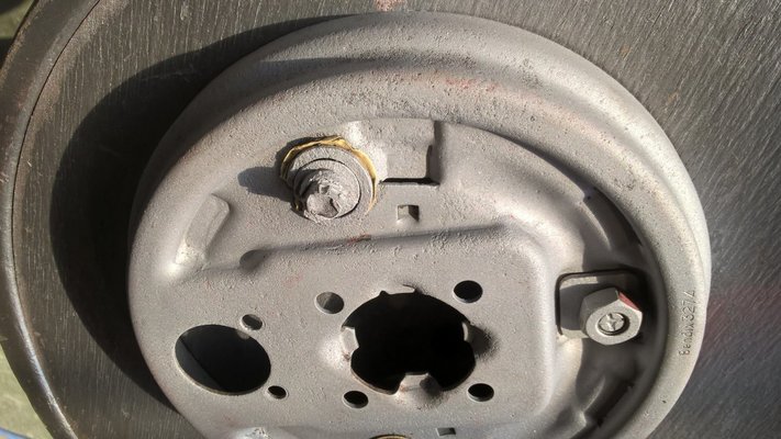

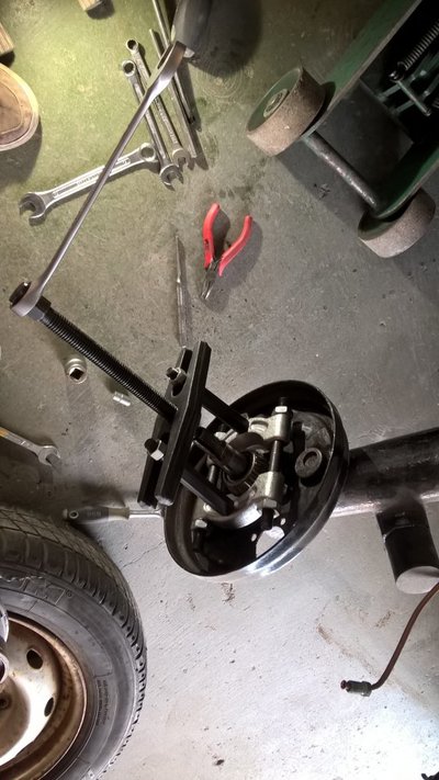

To work on it, I had to remove the bearing and backing plate:
Then I sandblasted it, you can clearly see the damage
I welded new steel on the damaged part for reworking the square
Square done, but then I noticed the broken down ring, awwww crap! Don't know what have happened here! The adjustment bolt was all loose.

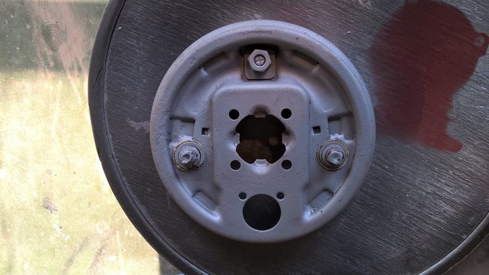

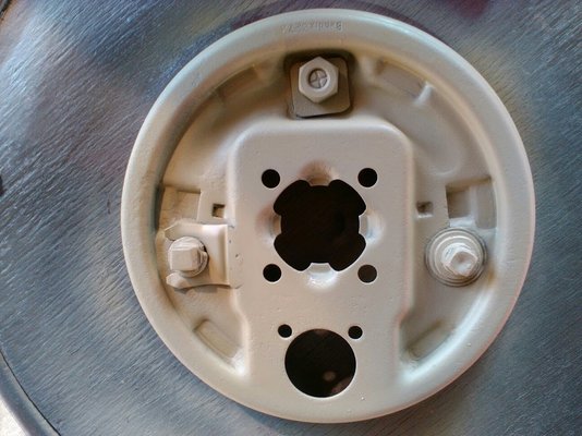

Instead of buying a new backing plate, I use a brake hose spring clamp (don't know englisch translation) to add tension on the adjustment bolt. It is not an optimal solution, but at least I can now adjust the brake shoe.. :)

Nice work and improvisation on the broken ring ;) and the cause of a broken ring ... hmmmm... could be a very rare R4 phenomenon called metal fatique :D but I think the signs of the broken ring were already visible on the photo's.
Cheers, Joop

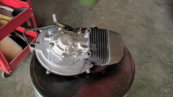

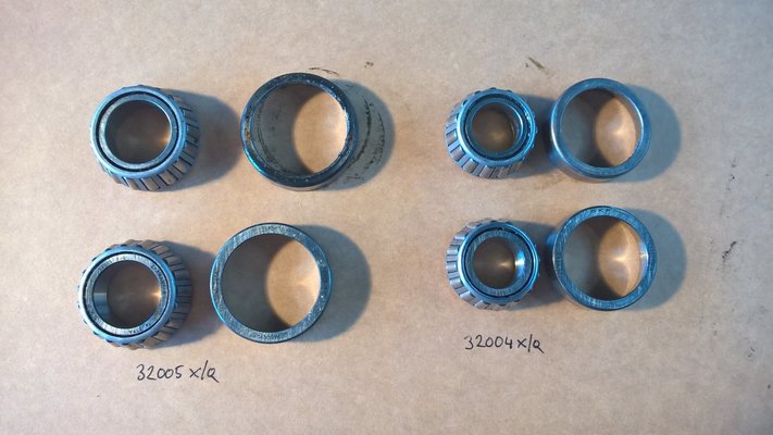

Busy weekend! I replaced the old bearings on the rear axle by a new SKF set. Above = old, underneath = new

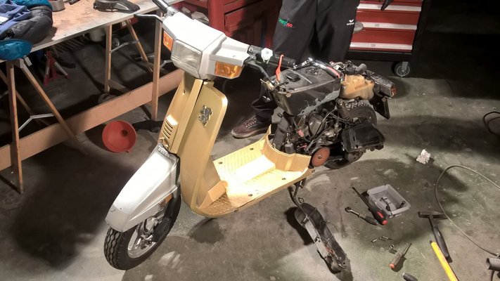

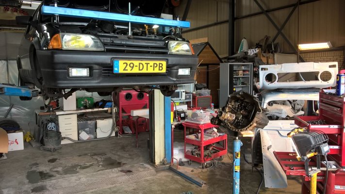

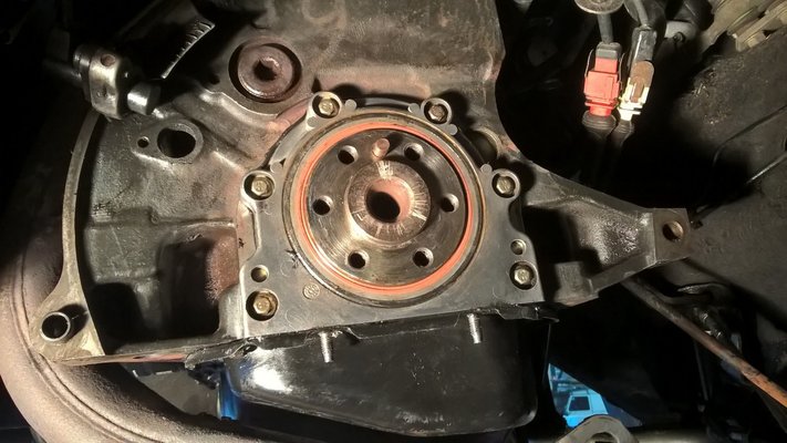

And, for something totally else - a hell of a job replacing the crankshaftbearing & clutch replacement on my AX. So little room to work in! Aaaargh..

And - "for the most ugly moped award" - my workshop buddy bought a Peugeot Rapido '94. But the fun is, it is really damm fast!
When our cars are done we will work on it.

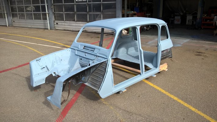

Now back to the body work..
Hi Jurjen,
Good to see that, beside your normal profession, you're almost turned to a full car mechanic :D and I can't believe that you've "So little room to work in!" judging to my own eyes after paying a visit at the mancave over there :)
Question, did you order the bearings at R-Quatre (or the Frenchman) and do they come with new inner and outer seals?
Keep up all the good work
Hi Joop,
Thanks! Haha, I meant little room in the engine compartment. I have no complaints on our mancave!
I ordered the bearings on www.lagerboer.nl. I did use the seals which were already on the axle - not ideal - but I haven't found them sold separately on the internet? Any advice most welcome!
Hahaa oh no room in that Citroen AX OK that makes sense in a R4 engine compartment you can easily swim around.
Hi Jurjen,
You can give Jan-Willem (R-Quatre) a call and when you know the partnumber (inside the workshop manual) he can tell you if there's still NOS available or otherwise aftermarket.
Greets, Joop
