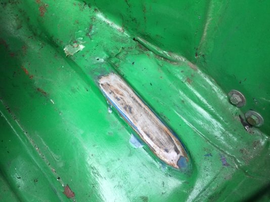

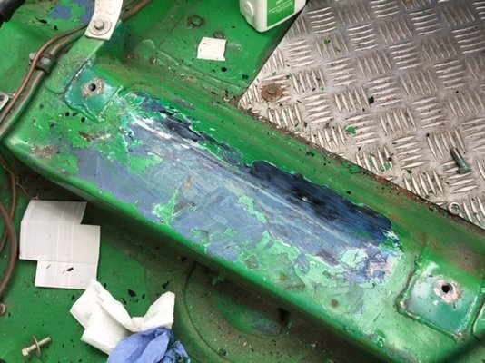

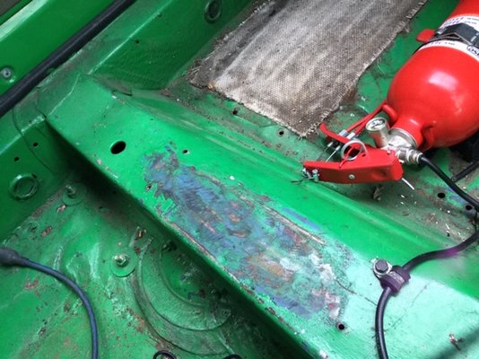

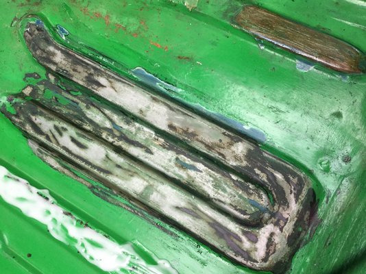

i remembered discussing this with you angel and if this forum had a tagging system I would have tagged youLook on the second or third swaging of the boot floor, counting from the right. The chassis number should be there as your car is post-80. Use paint stripper, it's dot-matrixed and not too deep imprinted.
