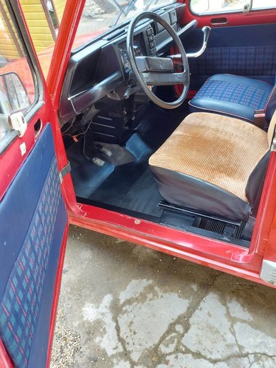

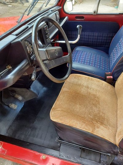

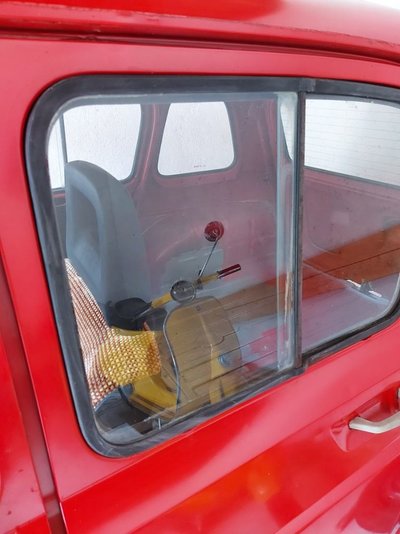

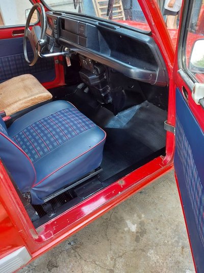

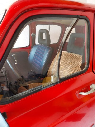

The yellow drivers seat is just temporary, I need to find blue one, that is in good order.
