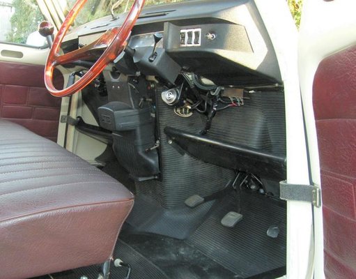

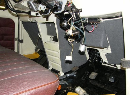

I've been messing around with soundproofing on the Gordini. The latest experiment was putting heavy layer and foam on the cabin side of the bulkhead (the most important treatment in modern cars, but missing on the Renault 4). I've used a rubber floor mat spaced off the bulkhead by 12mm foam.
Soundproofing on the bulkhead transforms the car! The noise from the engine is quite a broad spectrum so you don't really realise how much there is until you take your foot off the throttle and press the clutch in at 70mph. On the Gordini the soundproofing vastly reduced the level of that noise and surprisingly it also got rid of a couple of annoying booms.

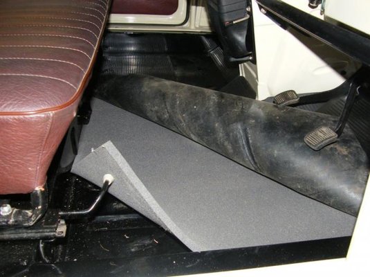

The only other thing that seems to make a difference (but the effect is not all that noticeable until the bulkhead has been treated) is foam under all the existing foam mats. This is the other major bit of soundproofing modern cars have, and is an easy modification to make to the R4.

As you have used material that will melt, have you put any heat sheild on the manifold as I remember things were rather hot in that area on the inside?

Interestingly when i got my tl i lifted the mat to find a thick layer of some crazy black stuff. It was like horse hair and black brittle plastic mixed up. I guess it was a sound proofing.
I pulled it all out as it was wet and sure enough water had started eating the floor in a few spots.
Was this stuff standard issue at some point i wonder?
The horse hair and tar was fitted by Renault - it's a damping material. I tend to remove it to paint the floors to stop them from rusting. I'm not convinced it is the best solution - I haven't put any damping on the floor of my car.
The foam on the bulkhead keeps the car much cooler and I'd forgotten about the hot exhaust. I think there is some stuff at work I might be allowed to have to go on the engine side of the bulkhead to keep the heat out.
