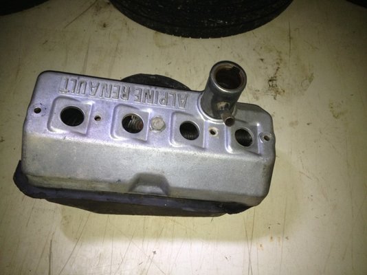

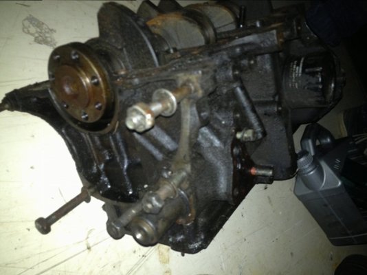

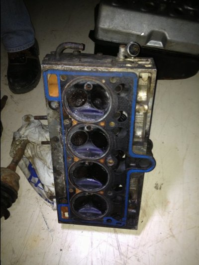

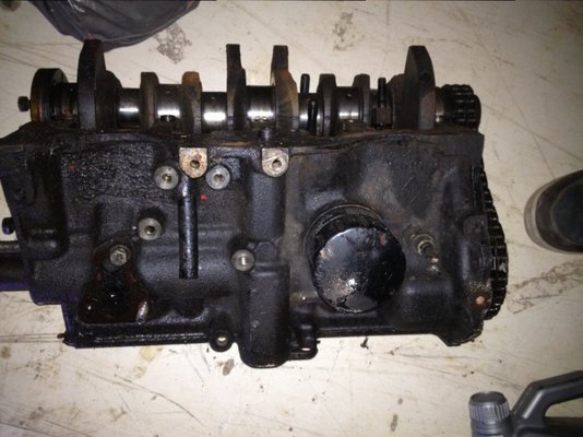

image.jpg image.jpg image.jpg image.jpg image.jpg This motor and gearbox was driven here, then removed for a racing project that never got funded.

The engine will fit into a left hand drive GTL. You'll need the complete engine with Alpine carburettor, inlet and exhaust manifolds, distributor.
There is some messing around modifying cables, air filter, and you would need to make a custom exhaust. You can use the R4 GTL gearbox (the Alpine one won't fit). Have a look at http://www.renault4.co.uk/renault-4-restoration.htm It's a bit more complicated because it is right hand drive.

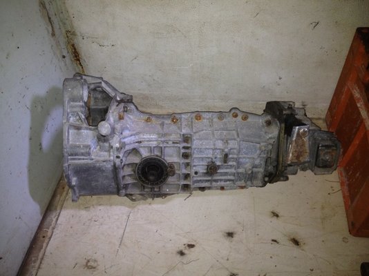

Thanks, Malcolm! I've noticed also that the gearbox seems to be from the Alpine Turbo - it's longer and the shifter is at the far end. The distributor is there, but the intake and exh manifolds are not.

The Alpine gearbox will not fit in the R4 without a lot of modifications. The R4 GTL gearbox is strong enough. I'm using a Renault 5 GTL gearbox in mine which has nicer ratios, but I know some people use R4 GTL gearboxes. You'll need intake and exhaust manifolds and the carburettor.
