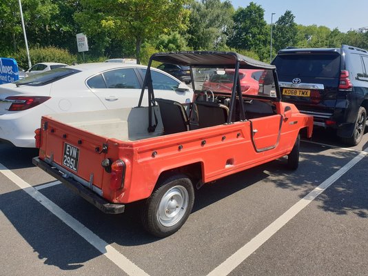

The Rodeo made it to Tesco about 5 miles away on it's second attempt and I put some petrol in to see if the fuel gauge works. It doesn't and I think it's the sender. The speedometer doesn't work either - it gets stuck because of a bent needle. There is an uncomfortable vibration in the seatbelt that's driven by the hood flapping around. Should fix that with a full length roof so I'll need to go and see the trimmer again. The driveshafts seem fine. I think it was the sticking brakes causing the knocking.

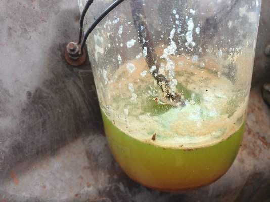

Oh heck - bubbly froth in the expansion bottle. I've ordered a head gasket kit.
It probably is the head gasket pushing combustion gasses into the water but I've got a test - let the car cool overnight and remove the expansion bottle cap the next morning. If it hisses then there is more stuff in the cooling system than there was when the cap was last tightened so combustion gasses are getting in. EDIT> That didn't work - I think the system was de-pressurising back into the cylinder or it has a leak.
There is no overheating or any other sign apart from the oily froth which makes me a bit suspicious. But froth needs gas.

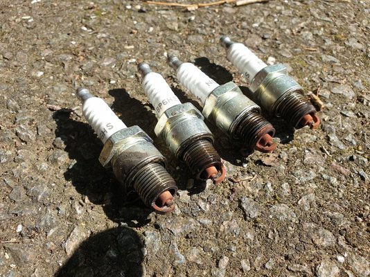

Old fuel won't be helping as it runs best well off the factory recommended timing. I think the fuel is burning too slowly. Pulled the plugs out to see if they were dark or light grey and turns out they are orange! Internet says it might be due to an additive but the fuel is discoloured and it might be rust which won't be good for the engine. I don't know how much 13 year old fuel was in there because the fuel sender doesn't work.

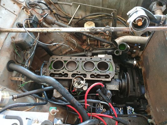

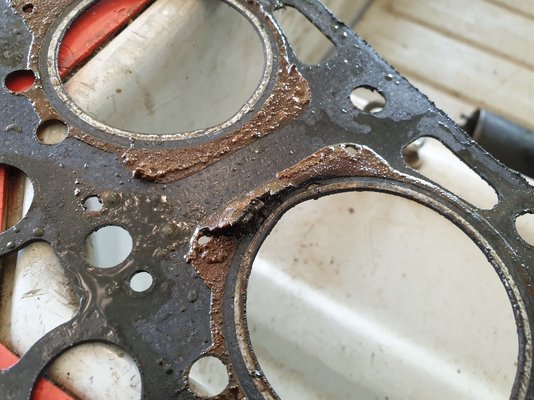

Tested compression - 120psi to 140psi so not terrible but not brilliant either. There are regular bubbles going into the expansion bottle at idle so I probably will need to fit the new head gasket.
I went out to change a carburettor and went a bit too far. :laughing:
There was froth in the expansion bottle which I guessed was combustion gas blowing into the coolant through the head gasket. There was no water in the oil. Sure enough the head gasket was damaged. I've not seen one fail like that before and it's possible the gasket failure caused the combustion leak rather than the other way around. The head was almost within tolerance so I just fitted a new gasket and put it back together. The engine still works which is promising.

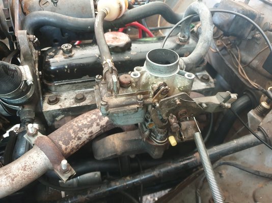

Next job is the carburettor.
I fitted the Zenith 28IF carburettor. Now strange things are happening and the car won't run well. I did take the distributor apart (and replace the head gasket) over the last couple of days and but I think the problem might be a very weak spark that the new carb has shown up.
The carburettor seems promising for performance. Now I can get to 80km/h on part throttle but any more throttle and it bogs down. The engine also dies with the slightest choke. I think as soon as the mixture gets a bit rich the spark plugs stop sparking. I got zapped touching the distributor cap which might be a clue the spark has other ways to get to ground when the combustion chamber seems too difficult. A new cap and rotor arm are on order.

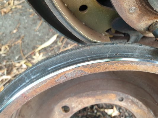

The Rodeo broke twice today. 8km away from home I had a bad knocking noise from somewhere near the front left hub. I found the noise mostly went away at about 50km/h so decided to try to make it home. 2km away from home the engine died. It started again after a few minutes then died again so I waited half an hour and it worked well enough to get home with a really loud knocking from the hub.
I had expected the knocking was from something broken in the brakes but they looked fine. The brake drum had wear all around the edge where it had been contacting the back plate. Turning the wheel with the brake drum removed it would get to a stiff point then suddenly release. I think a wheel bearing has disintegrated.

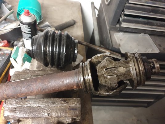

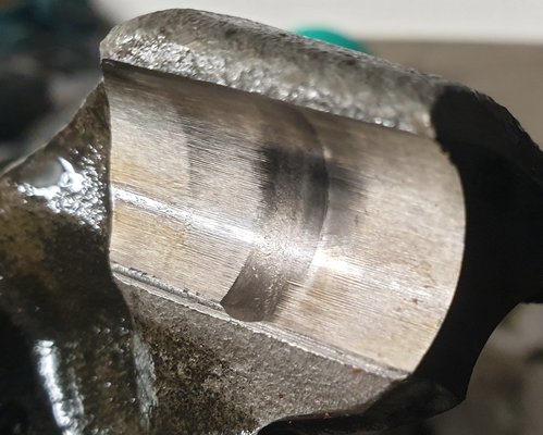

I took the driveshaft off. The CV joint is very stiff and the joint can't be moved by hand. I think these are old stock reproduction driveshafts and the bearing surface is roughly finished and has a deep wear mark. That's a lot of wear for 100km so I will probably need a pair of driveshafts and not just the one.
A seized joint would account for the knock. But the bearing isn't good either - it has a tick so that'll need replacing.

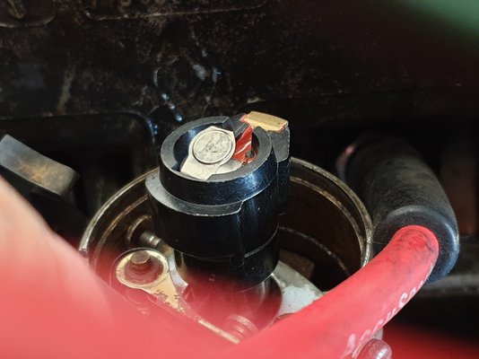

I've got a new theory on the engine cutting out. These days rotor arms tend to be made from a plastic that conducts electricity when it gets hot. I had the trouble in the MG and it is difficult to diagnose as the rotor arm cools quickly when you remove the cap. I'll try to find an old stock one.

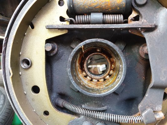

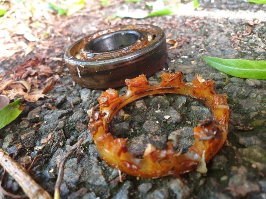

I started changing front wheel bearings and found the plastic parts that retain the ball bearings had fallen out. All the balls were at one side of the bearing which would account for the loud knocking on the last run.
The other side doesn't turn smoothly so another pair of bearings on order so I can fit the other driveshaft next weekend.
It was a funny bearing construction with plastic used to distribute a smaller than normal number of balls evenly. Probably it's a modern replacement bearing and they've saved some money. Traditional bearings work until the grease runs out but this one worked only until the plastic fell out. The ones that went back in are the traditional metal cage design.
