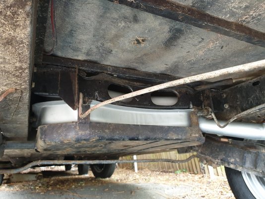

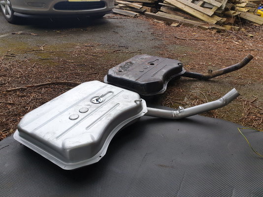

The fuel tank took 3 weeks to arrive. A week in customs then a week and a half trying to get the reference number I needed to pay the customs charge. Still, it's here now and fitted with the tank guard in case I go off-roading.
This one was from Der Franzose but I suspect all the suppliers sell the same one. It's the smaller earlier tank and quite a good reproduction apart from the untidy bends in the filler pipe. It looks bare metal in the photos but is painted silver. It needed the edges bending upwards to clear the suspension bolts but otherwise fitted well. The fuel gauge works now!
