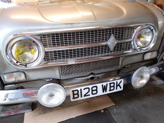

In preparation for winter I thought if look into some front spotlights. So I can see where I'm going essentially. Where is the favourite place to mount them? And any suggestions as to which to go for?

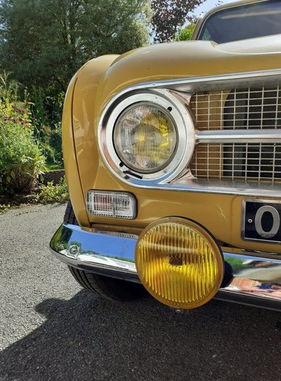

Really like the look of where Jnr. Renospeed fitted his spotlights, just look ‘right’
I think those are FOG lights, as the vertical slats suggest they are. In addition, they're yellow and are mounted lower than spotlights should be. Remember to check the "Construction and Use" rules when installing extra lights (available on line) since lights below a certain height may only be used in conditions of fog or falling snow. Furthermore the spotlights should be wired in such a way that they are extinguished when the main beam is switched off.
I fitted my fog lights in the same fashion, and I often use them as running/marker lights, so I can be seen in the hubbub of modern traffic.20200826_140240.jpg

Great advice gentlemen. I am very grateful. I've seen someone fit them in that way behind the grill and that looks the best I think.
Hi Elwood, just a thought but if you mount in front of the grill, won't that restrict airflow into the engine bay?
Cheers Simon.
It never restricted airflow in the R4 from the Marreau brothers in the real Paris-Dakar rally.
