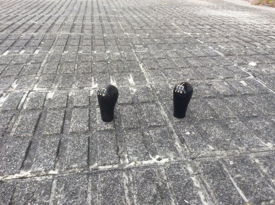

If there in better nick than yours I have the choice of two for the price of postage ( from Spain), replaced my original (83Kkm) with aftermarket, it would spin if lent on but had not been taped up, on left of pic. 24B17DC2-CAEC-4355-B5F4-EACF34443CDF.jpeg the other came with van in a bag of bits and bobs. Would like to keep one, but welcome to other if its an improvement, if you zoom you can see there not perfect but usable, better of on a car than in a bag..or heres what looks to be a v-good as opposed to good ( no cracks in white ):-

If there in better nick than yours I have the choice of two for the price of postage ( from Spain), replaced my original (83Kkm) with aftermarket, it would spin if lent on but had not been taped up, on left of pic. View attachment 24336 the other came with van in a bag of bits and bobs. Would like to keep one, but welcome to other if its an improvement, if you zoom you can see there not perfect but usable, better of on a car than in a bag..or heres what looks to be a v-good as opposed to good ( no cracks in white ):-

Will put in bubble wrap envelope and take to post office for shipping price Monday, will use forum message service to advise of cost and pass details on if all OK. There both good usable, tbh I’ll clean up the dirtier one off my van and send the best out of the two, happy to see it go to be used instead of collecting dust..
