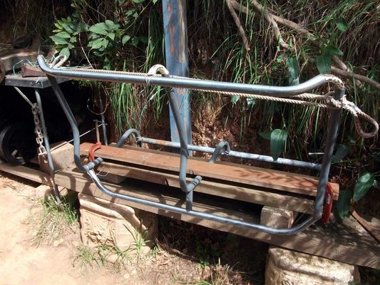

I have just about given up on the steering wheel, but have had some success with the bumpers and seat frame- There is a local manufacturer of vintage/classic exhaust systems who is making up the tubes. I am still looking out for the rear mounting brackets but think I can have them made up locally as well.
The seat frame for the rear seat is also now in hand as I was able to use some of the pipework from the later part hammock/part cushion frames I have. The only mod required was to cut the side pieces near the front of the seat and swing the front section down through 90 degrees, then some 1" gal pipe to join all the bits. Here is a picture of the frame all tied up and wired together prior to having it welded.
I'll post more photos as this project proceeds. Ron
