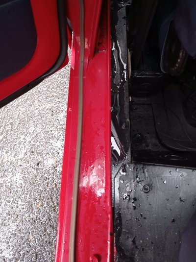

I have observed my r4 become a pool over the past months, which is nothing unusual as this forum suggests. So i tried to identify the leaks :
- on the sides of the pillars some drops tend to drift past the weatherstrip
-windows , (probably didnt do a splendid job of sealing them with mastic) so it drips down the doors
- bolts on the firewall , but i managed to locate and smear them with some putty.

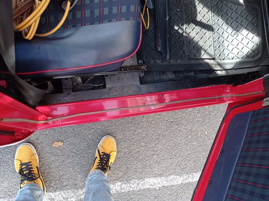

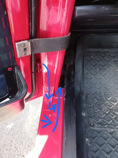

So i had the idea to create a small barrier with some adhesive weatherstrip from a local shop.
Down you can find a poorly drawn picture where water seems to go and also my take on the solution using this brown strip.
Might be silly , i am sure you guys have better options, but i will keep you posted on how this works.

Do you have a plastic trim on the doorstep? Missing or removed from doorstep?
