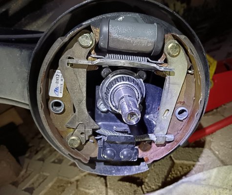

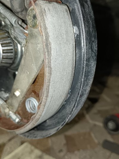

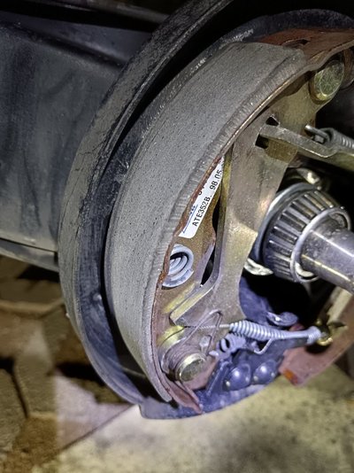

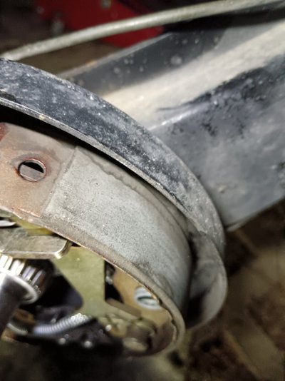

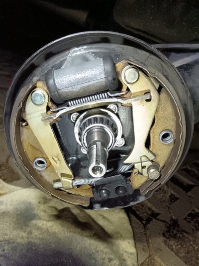

Then sanded rear pads and washed rear brakes from dust

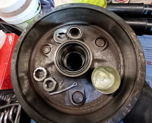

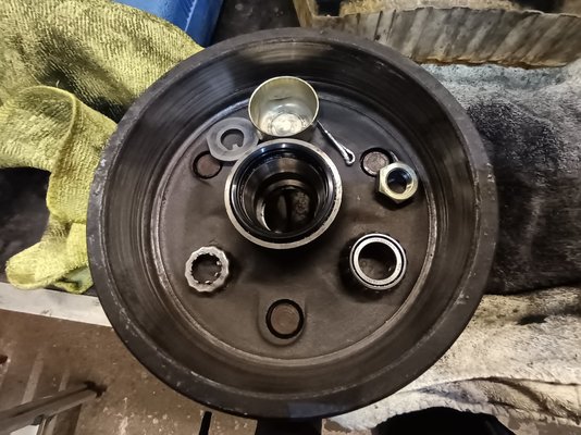

After that drums came in line. Sanding, cleaning from dust, removing old grease
Put them back on car, new grease on bearing.
Meanwhile brake oil started to drip from bleeding nipple. Closed nipple and pressed few times brake to adjust pads. Tightened hand brake.

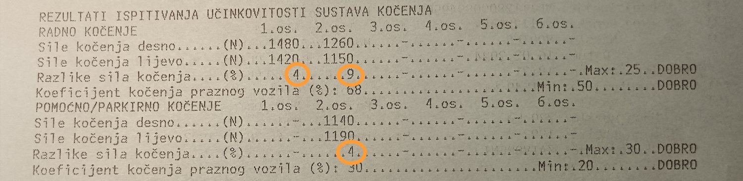

Went for test ride. Handbrake is working fine, brake pedal is still soft and need to pump it up for perfect brake power, but not surprised as i did not bleed calipers as they should be bleed. Need one more pair of feet to do that. Hope to get them (one more pair of feet) tomorrow.
